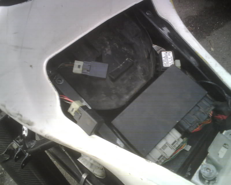

I may have left the ignition on the bike for sometime and today when i went to start it all i got is some clicking and some weird noises from one of these two relays im not sure what theyre called so i took a picture. As soon as i turn the kill switch those relays make the noises and the fuel pump doesnt prime and i get nothing
how common is it for those relays to go, also what are they so i can start looking or am i in for a deeper problem than just those relays

ive tried switching the two relays and still nothing, the bike isnt even turning over.
and it ran a few days ago so i dunno wtf

check your battery you said you left your ignition on so id make sure your battery is fully charged. the relays click when turning your bike on - i dunno about the noise youre talkin about tho.

it was the batt
Thanks dude
