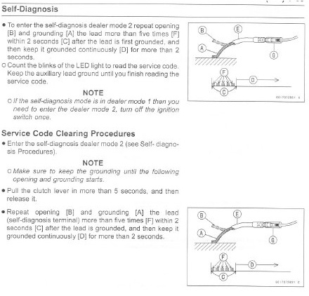

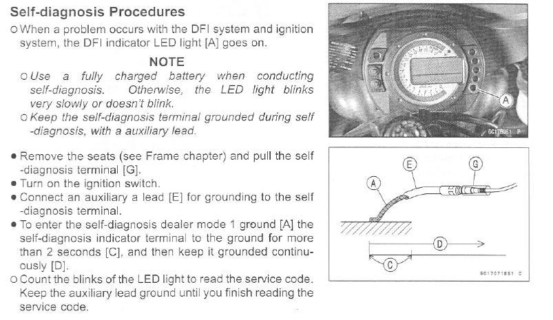

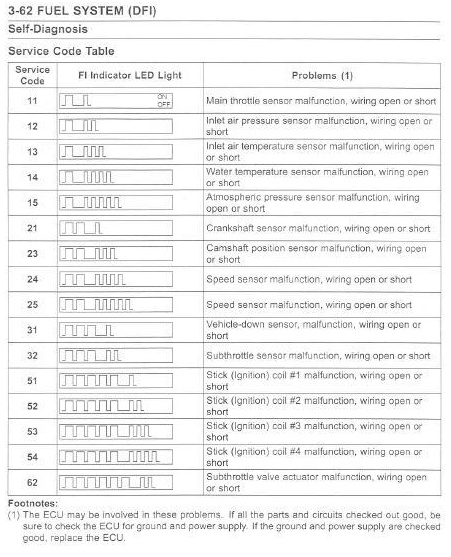

Re: 636 fuelpump trouble
self diagnosis mode
ok to make sure if the fuel pump works or not, if you know how to use a probe, you ll need to feed current to the brown fuel pump plug forgot which color wire) the if it primes the problem isn't in the pump.
could you check if there is spark or not, let me know
ps: for the self diagnosis you can use any wire as long as there is contact to the frame and the yellow plug on the right hand side of your battery

ey,
Well if tried alot for the past days. Swapped out alot of parts with another 636. Relais, tank, pump and the (don't excactly know how its called) voltageregulator.
My fualpump works fine.
I have got a spark.
The problem is that the fuelpump is not getting enough energy.
I've(manually) checked kill switch, neutral thingy, clutch thingy, kick stand thingy.
All the fuses ar absolutly fine. The ones in the big black box, the ones in the white stashed behinh the big black box. And the one Fuse Arjan found in that little black box connected to the
I've I ground my meter *** usual for measuring stuff en then touch 1 of the wires going into the relias from the bike I can hear the fualpump arming itself. But because in this way i'm bypassing the relais it builds pressure infenitly and the bike still doesn't start.
I''m running out of ideas. And getting slightly anoid...
sorry for the late reply. stuntlife was acting up, could get on.
Thnx for the diagnostic stuff. If I still have my sanity ill try this in the afternoon.
