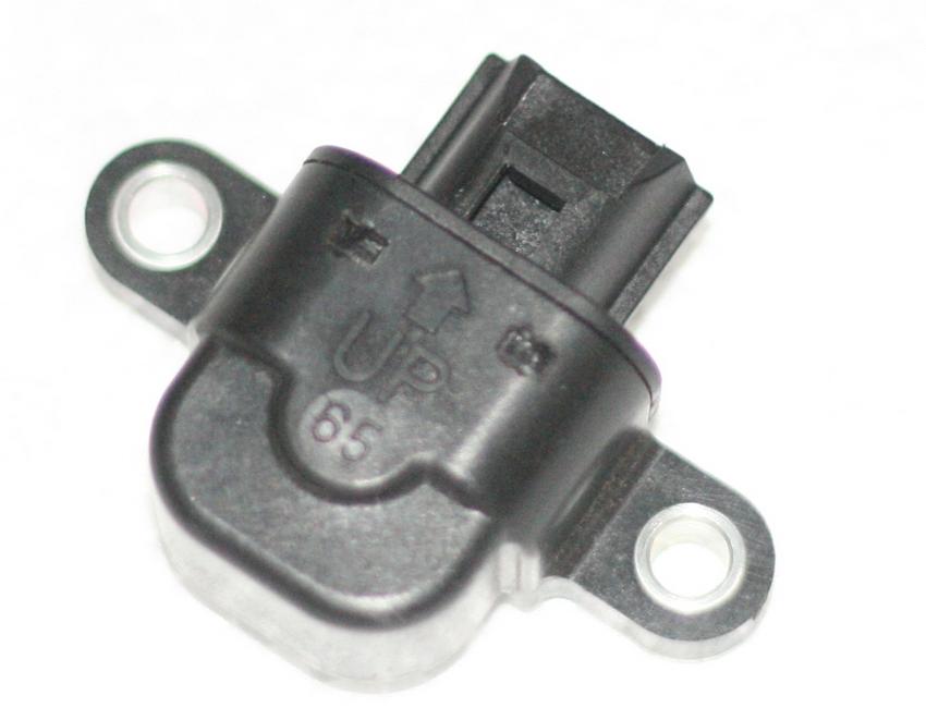

I think I have it out, now I just need to find out how to get it open without destroying it.
Is this it in the picture?
Old Oct 20, 2008 | 12:06 PM
JohnnyP's Avatar
Posts: 3,289
From: Toronto
JohnnyP is a decent person
Re: tip over sensor (zx6r)
Thats it, pry it open and spill out the moving part from inside...Then just close it back up...And it doenst even matter if you break the plastic shell...
Old Oct 20, 2008 | 12:28 PM
Halliwood's Avatar
Posts: 223
From: Lexington KY
Halliwood is an unknown quantity at this point
thanks guys, everything is working perfect now
workrd on my 08 pry apart pop out spinner put back together an DONE:che ers
I had to revive this from the dead as it save me time, money and a hell of a lot of headache! I just bought an 06 zx6r that had been down and someone had done work to it. Well it wouldn't run but had all of the signs above. Start for couple seconds then dead. Turn key off, reprimes fuel pump, run for couple seconds then dead.
It turned out some knucklehead put the tip sensor in upside down. I was ready to buy fuel pump, injectors, etc. as I thought it was 100% fuel related.
Thanks!
