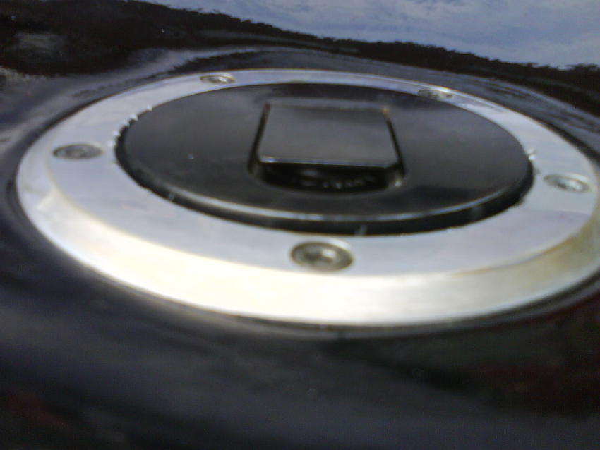

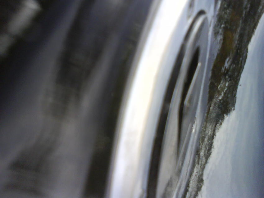

i got a vortex and it leaked uncontrollably, i did everything i could think of to get it to stop and it wouldnt
i ended up with a new tank and stock gas cap and it leaked just a little bit after i dented it. i put a longer screw with a wider flat washer in the top bolt of the cap, tightened it so it would push the middle part down and it only barely leaks when i fill my tank all the way up.
you should try it, here's pics hopefully you can tell what i am talking about

Old Sep 8, 2008 | 04:23 PM
Re-Micks's Avatar
YUT UGH
Joined: Feb 2007
Posts: 1,570
From: Cincinnati, Ohio
Re-Micks is a decent person
Re: gas cap leaks ive tried every thing
so then you tighten the screw once you fill up on gas?

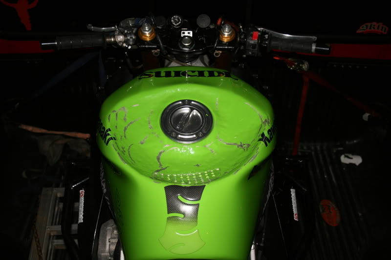

Old Sep 8, 2008 | 04:29 PM
Suicidl's Avatar
WWW.Sickinnovations.com
Posts: 18,216
From: Usa
my vortex does not leak at all. but the stock one did not either

Old Sep 8, 2008 | 04:40 PM
atl freestyle's Avatar
ROWDY'S WHEELIES
Posts: 4,759
From: in the A!!
atl freestyle is an unknown quantity at this point
EXACTLY
i dont know about your cap but just about every gas cap i have seen on a 636 it sticks up past the base, having that washer there will push the cap flush with the base when you tighten the screw. thus sealing it better. worked great for me

Gas *** sucks I have had a bunch of 636 tanks leak. I am gonna try the screw method. Can't you just grind those washers so you can open the cap without carrying a phillips. Or is it the cap won't open unless the screw is loose?
Old Sep 8, 2008 | 06:21 PM
ToKwik's Avatar
Posts: 362
From: Georgia
ToKwik is an unknown quantity at this point
The washer is actually what is applying pressure to the cap. It is compressing the springs and forcing a tighter seal with the tank.

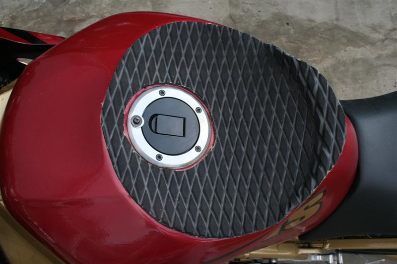

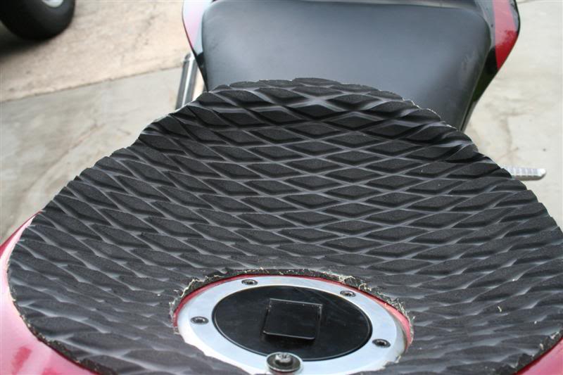

Old Sep 8, 2008 | 06:33 PM
Re-Micks's Avatar
YUT UGH
Joined: Feb 2007
Posts: 1,570
here it is pretty much the same dent as yours *****

Old Sep 8, 2008 | 07:54 PM
MikeOnTheBike's Avatar
WWW.IDOLRIDERS.COM
Joined: Mar 2006
Posts: 1,148
From: Sacramento, Ca, USA, Earth
MikeOnTheBike is an unknown quantity at this point
great idea I almost did the same thing, you are very close to the fix but not quite.
I had the super leaker cap on my f4i after denting my tank and saw the front lip sticking up and was going to go with your idea, but I was thinking "WHY IS IT LIPPED UP IN THE FRONT??"
ANSWER; it's because when we smash in the tanks the rear mounting locations distort and GET LOWER than they are supposed to be in relation to the actual top of the hole causing the cap to sit all crooked when it's latched cause the back is actually too low.
SOLUTION just slip a washer UNDER each REAR mount hole under the cap and then tighten as usual and there should be no more gas ***.
NOTE might take some trial and error with washer thickness and numbers. I used 1 lock washer on the back of both bolts for mine.
