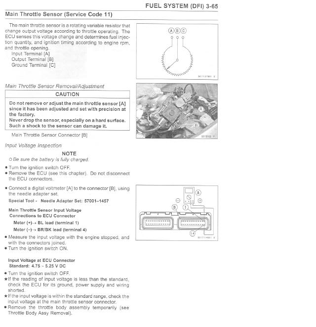

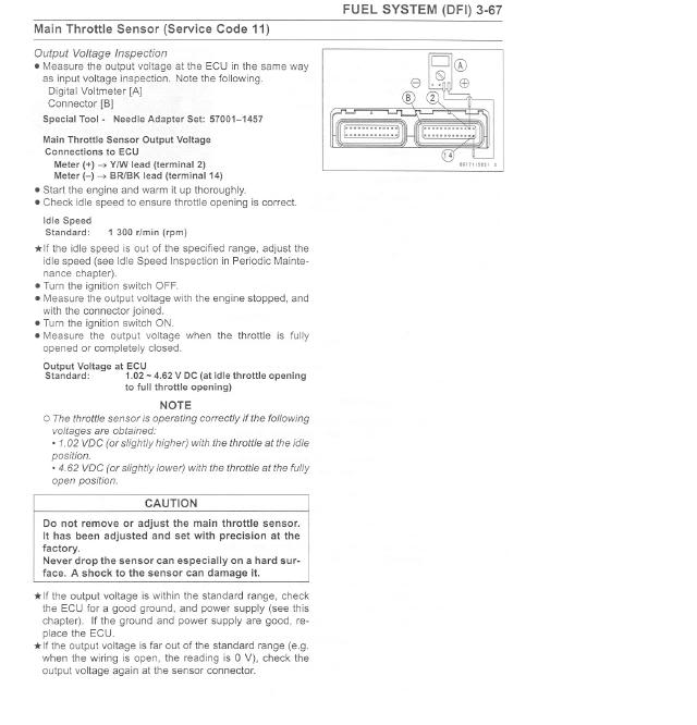

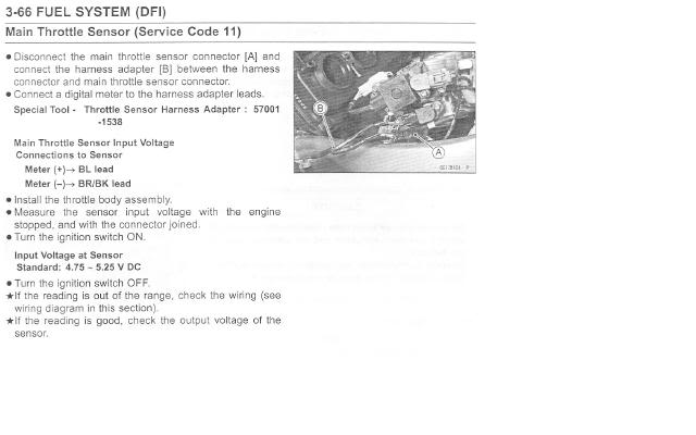

ToKwik's Avatar
Posts: 362
From: Georgia
ToKwik is an unknown quantity at this point
Re: 03 636, throttle BOGGGGG HELP
Ahh, no worries.
The ECU locks the ignition timing at a fully closed position when it sees the TPS out of the usable range. That would explain the secondary butterflys not operating.
I'll post up the TPS procedures.

Old Oct 30, 2008 | 09:40 PM
ToKwik's Avatar
Posts: 362
From: Georgia
Let me know if you can't read any of these.
