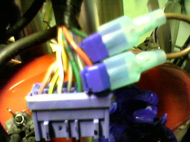

here's a crappy cell pic of how mine is jumped. hope this helps.

So you have to actually connect the wires to the some of the main wires on the main harness as well? I thought you could just take the two outer wires like KAZ was saying and splice them and connect them two eachother and that would do it. Red to Green on one side and Green to Red on another side. Let me know if this sounds right.

you have to connect the green and the red wire and tape the white of, the wires are comming out of a small black box inside your upper fairing
https://www.stuntlife.com/forums/443...er-sensor.html
