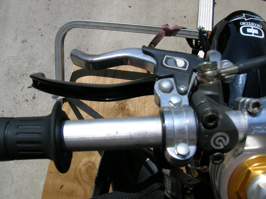

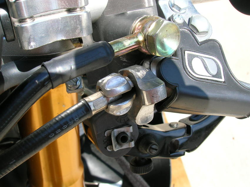

Originally Posted by paulieb1979
I brought a full throttle inc third brake kit. i was told to buy a 06 gsxr front brake master cyclinder, so i did. i have a msr raptor clutch lever and stock clip ons. i can not get the levers to go on together properly any help would be appreciated
I WOULDNT GRIND THE MASTER,JUST CUT 2 OF THE EARS OFF THE ADJUSTER ON THE CLUTCH...
HERE`S A PIC OF MINE
suzuki Radials have a huge cast block right there for the brake switch mount... so the ajuster even with out ears wont clear.
