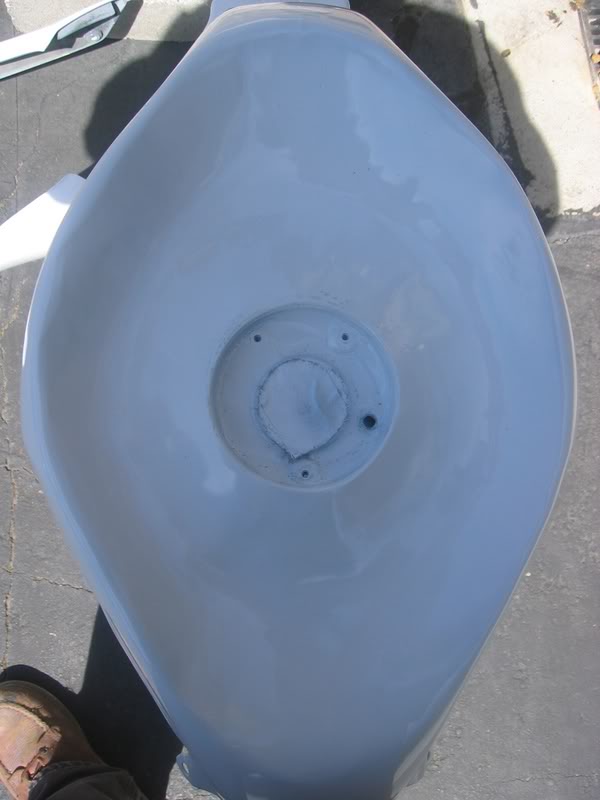

Well, I decided to give an extra set of fairings and tank the "Rustoleum Touch"
Below are Before and Progressive pictures of my progress. I will update day by day.
THIS IS NOT A PROFFESIONAL JOB, IF YOU HAVE MONEY FOR BONDO, RUSTOLEUM PRIMER, PAINT, AND A HARD RUBBER SLEDGE, well then I hope this will help out anyone new with questions.....Just food for thought. Materials cost $50.00 Home Depot. This will include everything I need for the tail fairing and front fender.
DAY 1
-Aircraft Stripper around area that I want to dent (because I want a new metal surface to work with.
-Play Egyptian Bone collector, and start denting away, (make sure you dont make your filler hole lop sided by focusing on hammering in one spot)
-Patch 2 holes I accidently made by pounding in, with JB weld.
-Sand sides, and Primer Sides.
-Make one Bondo Pass..will sand and bondo more Day 2.
TANK BEFORE::
TANK STRIPPED IN THE CENTER, SANDED ON THE SIDES::
TANK DENTED::
TANK PRIMED ON SIDES::
1ST BONDO PASS::
......That was Day 1..... I will put up more pics Tomorrow Morning of what happens tonight.

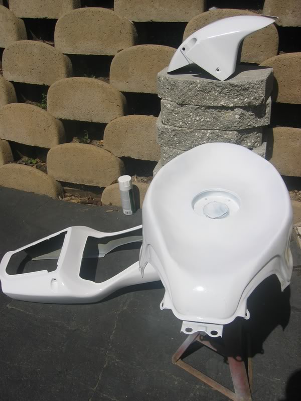

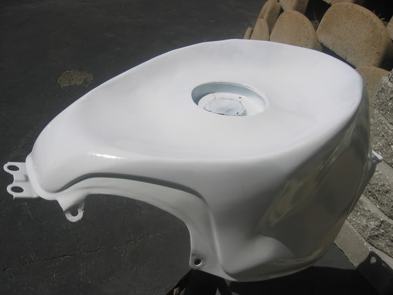

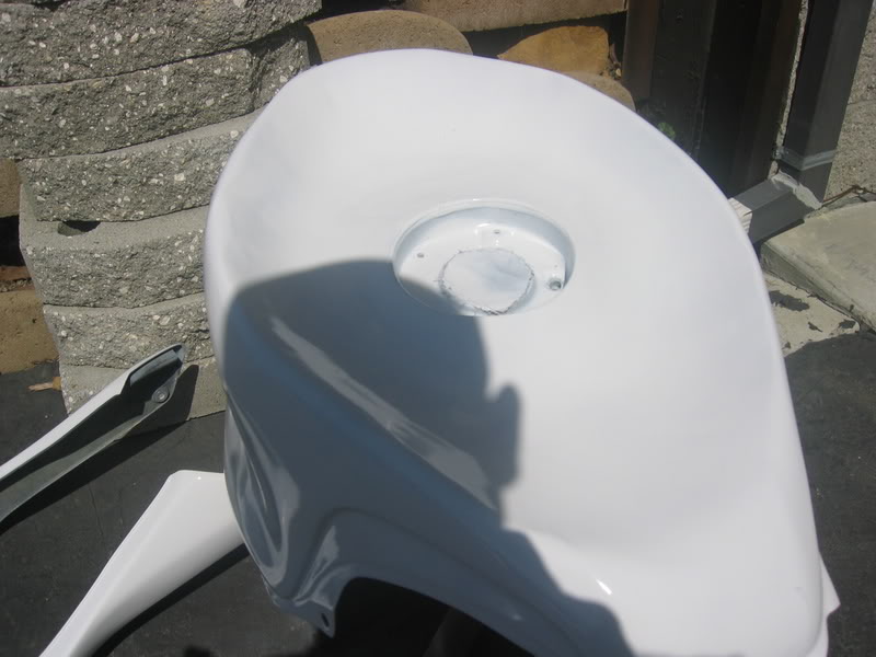

Well Thank You Rustoleum brand "Ultra Hard Enamel Epoxy", This **** gives a paint booth finish, no joke,glossy as F***, **** is hard,goes on thick and best of all WASHABLE/WAXABLE ! ! ! So far I have put 2 coats on, im about to wet sand this coat you see and then apply my final coat.
...I dunno, im very very happy with the results of this product, I ended up applying 4 coats of bondo, sanding with 60 then 150, between each bondo run. It COULD be a bit smoother, but hey its a stunt bike, two day project. 50 bucks later, 1 can of primer for everything, 1 can of finish color, a small tub of bondo, and I even bought a Ryobi orbital sander for $30 ! ! !
looks much glossier in person.
