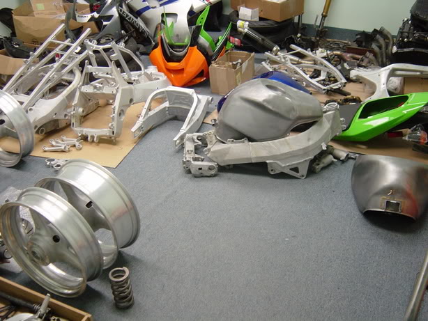

I know what Im talkin about, look at this pic eveything in it has been chemically stripped....The rims on the bottm left are 636 rims, stripped to the bone bare cast aluminum.....All modern sportbike rims are CAST aluminum....

FYI bare MAGNESIUM is a much darker colour then bare aluminum, worked with both alloys and can tell the differnce just holding the part in my hand....
Every OEM sportbike rim I have stripped has been cast aluminum, only OEM parts Ive seen made of MAG are some engine covers...
People polish the lip on their wheels all the time, if they were MAG that would be a very bad idea...1 like I said the ellemets would eat at the bare MAG fast and comprimise the wheels stregnth. 2 polishing MAG dust is poison....

well they were darker then my 636 wheels and they were off an older kawi so may be they had some magnesium in the mix ....
the word alloy does mean a mix of metals ,doesn't it ?
and like i said i have welded rear sets before and even a couple of frames and all kinds of differant aluminum and none of it ever explodeded before so i don't know what the hell it was but it wasn't just cast aluminium

its like a dreamers x-mass

Im not doubting your wheel you tried to weld inst aluminum, I dont know what wheel it was and I cant see or touch it...What Im saying is that F4i wheel this guy is asking about is made of aluminum alloy %255.55........GSXR, R6, R1, 954, F4i, 636, etc etc etc......Worked with all of them and they are all aluminum since before my time.....

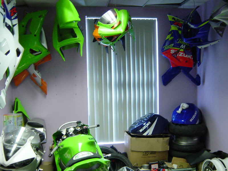

For the dreamers LOL
Got a seperate room just for spare parts, wish they were all mine Id trash every one....

now thats a "spare room".............LOL
