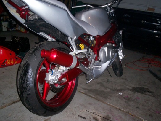

My CBR F4i dual caliper, rear handbrake set up

nice set up Ho hey, If you didn't sell me the welded bracket already i would of went with your new style.

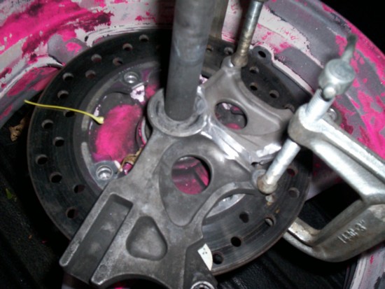

mines 2 stockers welded together. His new ones are machined

I still have 2 spare brackets and a spare caliper myself. I couldn't find anyone brave enough to cut and weld them for me.

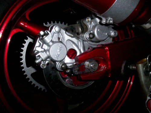

heres mine.........

oppps it didnt load

super pimp celgsxr, how long you been running it?

2 years...... i had one on my gsxr and when i just redid my f4i i put it on here... i personally like it better........ its easy to bleed.... not really any harder to take the wheel off i just take one 12 mm bolt off and take the extra caliper off and it like normal...

good to hear welds hold that long. thats my only fear, even though the welds are nice and sound

theres only one guy i trust to actually weld it... any one else i wouldnt even trust is unless i watched them weld it so i knew they took proper steps..... like grind a v real deep...weld flip and do the same...... and i good looking bead..

Sorry I wouldn’t want to have to make another one to do one right it takes some time and you got to know a really good welder. The one I sold to stuntrider227 was what I made for myself and trust me I took my time and made sure everything lined up perfect meaning the path which the added calipers brake pads run are line up perfectly on the rotor this is what takes time you cant cut one up and weld it together. I am talking to the machinist tomorrow and will know something on the bottom line price as far as the machined brackets.

perfectly located and rotor spins straight down the middle :YEAH
