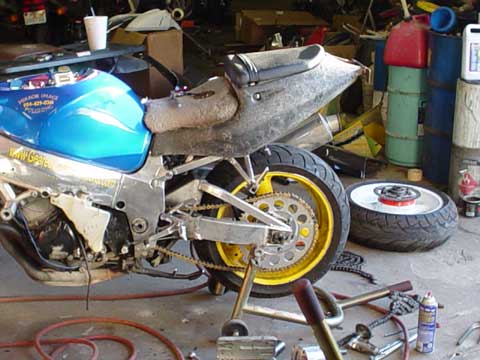

My 99 is one down 16 up not much on the street but its fun !!!!
The best for the Suzuki would be 1 down three up in rear!! It seemed like a all around good gearing..............lata
Name:	sprocket 2 web.jpg
