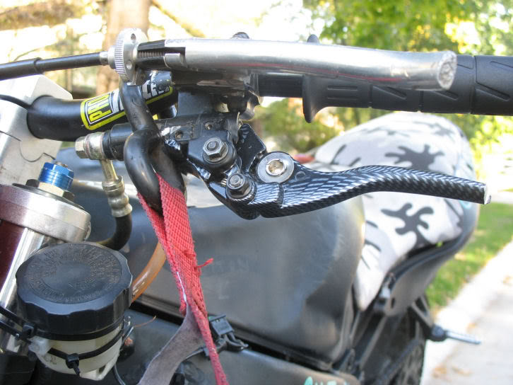

Hi just watched the clip, well good! love those combo circles.. looks like the r6 brake is really good to as it doesn't seem to hold you back.. is yours from the 01/02 year one? looks like I'll bid on that on ebay then.
Stupid question maybe, but where the master cylinder outlet goes to the remote cylinder, that'll be upside down when I put it on the left side.. so does the remote cylinder just then route back up and sit on top of the bars , if that makes sense?
http://cgi.ebay.co.uk/1998-2002-Yama...QQcmdZViewItem
that's the bit im on about.. just wondering how it fits on upside down.. I'm **** at mechanics so don't really know much.

no scanner but yes just use a long enough hose to make it to where you want the res to go it simple and try to get it as low as you can you dont want to bend your hand down when your doing seat standers( the lever is what you want low}

make sure the resovoir is above the MC when you bleed it. never let the air see the entrance to the m/c...otherwise youll have to bleed it again.
but once its bled you can put it lower like in the pic.
voila!

you can mount it low but remember air goes up hill so the chances are eventualy you will have a problem if you choose to mount the res low over fill it then put the cap on so theres no air in the res
