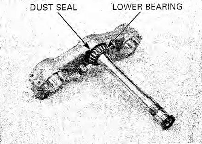

Originally Posted by STICKYstunts
Which races do I need?
Your all set.
You have the right ones... sorry to confuse you... there are no races on the stem... i meant the lower bearing, my bad! All ya gotta do is use the bearings and races that are already in the f4i frame neck. You don't even need to touch or worry about the races.
If the 954 front end you have has a tapered roller bearing on the bottom of the steering stem... just pop it off w/ a chisel/screwdriver and re-use the one off of the f4i stem.
Here's what the lower tapered roller looks like....

Old Apr 5, 2006 | 07:54 PM
kj's Avatar
kj
Posts: 2,277
From: South of Boston, 781
Re: 954 Roller Bearings
I just been trying to figure out what bearings and races I need to put this 954 front end on my f4i. I only have the f4i bearings and races.
To make this as easy as possible, just use what you have. The f4i ones work great and you don't have to spend a dime.
All you have to do is: if your 954 front end came w/ a bearing on the lower stem, make sure it dosen't look like the one I posted the pic of. If it looks like a regular ball bearing, then just bolt it up and go!
