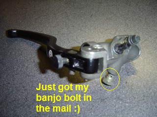

Okay today I got my Brembo 16x18 but the guy didn’t include the banjo bolt so I have to order one since its got to be from Brembo 929 or 636 bolt doesn’t work different threads Oh well I'll put one on order and post up once its hooked up.

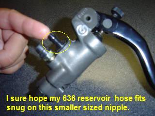

Just got my Brembo banjo bolt in the mail today so tomorrow I'll try to hook up my 16X18 Brembo brake master I just hope that I don’t run into a problem since the Brembo has a smaller nipple for the reservoir hose Oh well I'll post up on how well it goes and works tomorrow.

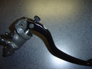

Okay I installed the Brembo 16x18 and compare to my 2003 636 master cylinder or a CBR 900 master cylinder it’s definitely a better master cylinder than both of those by far! Now as far as it being everything I had hoped well it’s not in my opinion but then again I am not also running a full throttle billet rear master cylinder. I cant afford a full throttle rear master and could use the money I spent on the Brembo 16x18 for car maintenance so if anyone is interested I’ll sell it for what I paid plus $7.00 banjo bolt

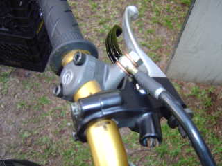

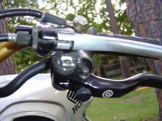

To me

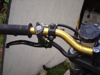

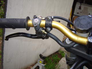

I putted it on yesterday, and it's just great !!! I don't know why you sold it Ho_Hey, but it's 10 times better then my previous master... I don't know what sort master it was, only thing I know is that it was a 14mm... Not even a radial...
But the pressure is great, the feeling also !! And my Clutch lever fitted imediately like a champ !! I thought it was going to be a problem to make it fit (like with most of the radial masters) but this fits even better then my previous master :YEAH
I can adjust everything exactly the way that I want it... More up, down, to the sides, The position of the lever (how far away it is from the handlebars) just everything !!! It rocks !
I haven't really stunted it yet, cause my handlebar mounting bolts are f*cked up, so my bars aren't exactly tightened the way they should... So I'm waiting for my new risers now...
But here's some pics from the master:
Owh BTW, I have try'd the master out with normal riding, and just a small sit down wheelie, but because of the bars that aren't secured, I'm afraid to really go out and stunt with it... So I have try'd the master out, that's why I can tell it rocks :YEAH And I ride with Fullthrottleinc as well, the only way to go, and so it seems, the perfect combination !
Thanks Ho_Hey for the great and fast service ! He shipped it out from the US to Holland, and it arrived here within a couple of days, great !
