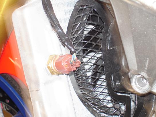

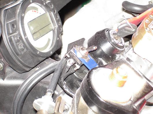

just did this to my 636.........had two wires that ran into my temp sensor, peel back the coating on both wires so bare wire is showing, get a switch and mount it where you want it, run one wire off the wires to the temp sensor to one side and the other to the other side of the switch....all your doing is puttin a toggle between the two wires on the temp sensor so it kicks on when hott and you can kick it one when stuntin.....

I wired a toggle between the + and - wires that connect to the temp sensor, didnt cut the wires just peeled some of the coating back and tapped into em so the fan still kickes on when bike gets hot......

but with that set up you wont be able to turn the fan on when its below 220F or whatever, that sounds like it jsut breaks the circuit coming from the temp sensor so you'll be able to turn the fan OFF when it would usually be ON when the bike is hot ... i might be retarded tho

With that set up I can turn the fan on whenever (even when the bike is off) and at 220 or so it will kick on by itself, all your doing is tappin into the circuit to be able to control it whenever....

OOOOOO ok gotcha now, sounds like a pretty slick set up
