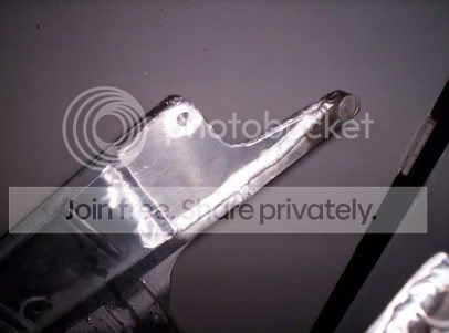

yea, just weld some plate to the area that needs strengthening...
Ill try to snap a pic, the sub's back on the bike in full trim now...but Ill see what I can do

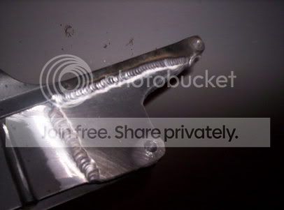

Originally Posted by mista_shrpnl
The new bracing extends back 6 inches from the front mount, and adds a thickness of .38, for a total width now of little over 5/8's of an inch.
The lower edge in the pics actually dips down into the chanelling of the subframe.
Subframes holding up like a tank...
I did the same Idea with my 03 r6 and so far its in one piece. PS suport it before you scrape it. I welded my subframe in 5 spots 3 difrent times
