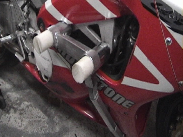

Behind the poly are valve springs.. you let the poly stick out like 2" so when the bike hits the valve springs take most of the hit. He made his from scratch, but I want to add to an FI cage with Zac's design!

that cage design above seems better since it distributes to 2 bolts on each side as opposed ot one. some kind of rear mounting brace with a loop or stator/clucth case protection would be great.
