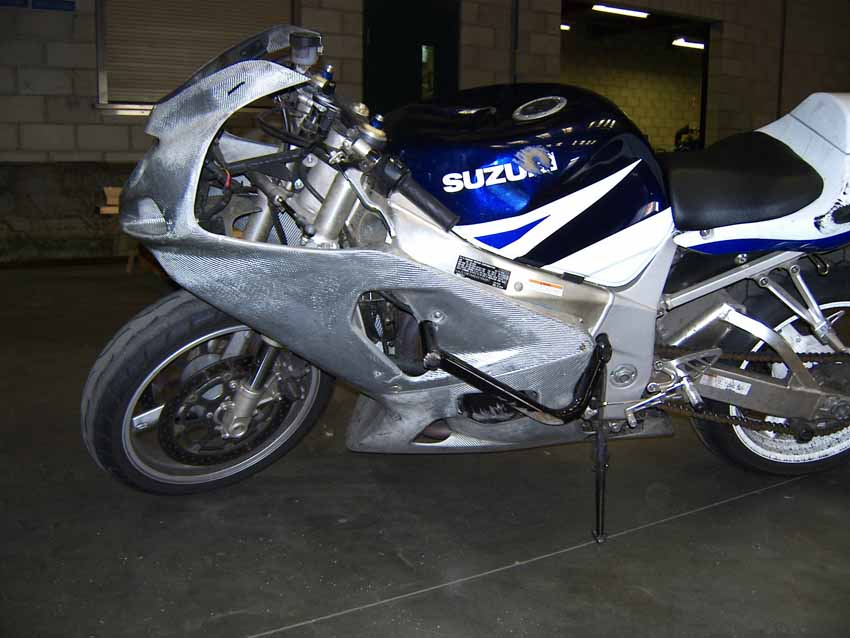

well then here is a pic of my buddie's GSXR who used just a street cage (RACE CAGE) im pretty sure it's a MXD cage also, but not 100%......
like i said before. you need to know what product you are talking about before you begin to bash it. THAT IS NOT A MXD CAGE on that bike.

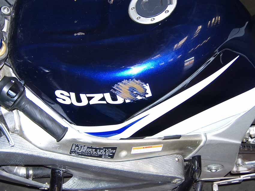

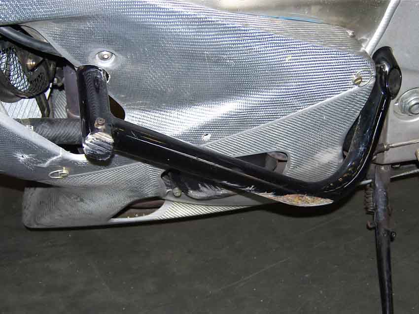

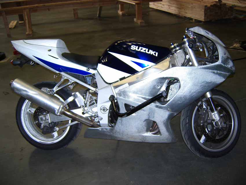

this is what our street cages look like for gsxrs. this bike has gone down about 10 times, it was a buddies bike that i bought for the parts. it went down on the freeway, a tank wheelie, a high side and few other low side wrecks. the damage done to the cases was the first wreck before he had the cage on his bike.
Name:	600 750 track ls side view close, mikes damage slife.jpg
ID:	153276   Click image for larger version
Name:	600 750 track ls side view, mikes damage slife.jpg
ID:	153277   Click image for larger version
Name:	600 750 track ls tank view close, mikes damage slife.jpg
ID:	153278   Click image for larger version
Name:	600 750 track rs side view, mikes damage slife.jpg
