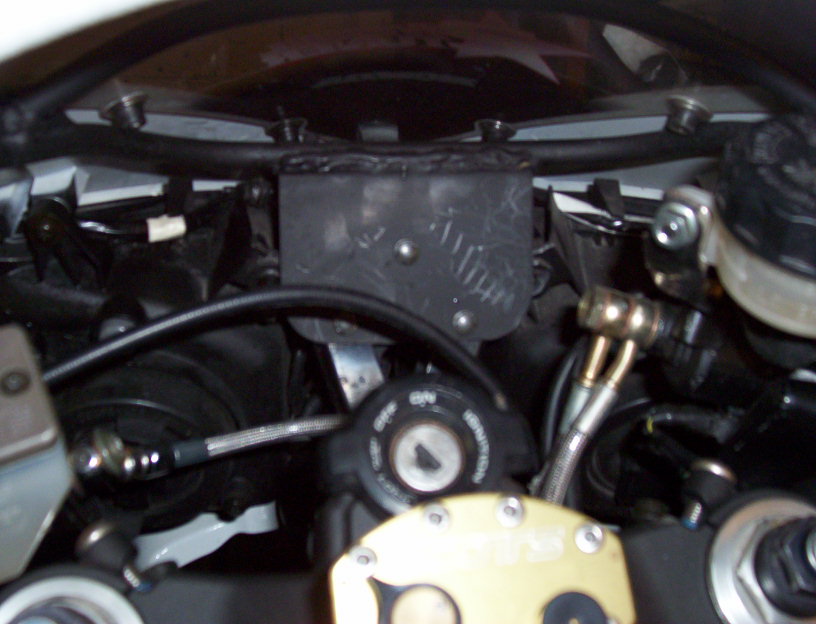

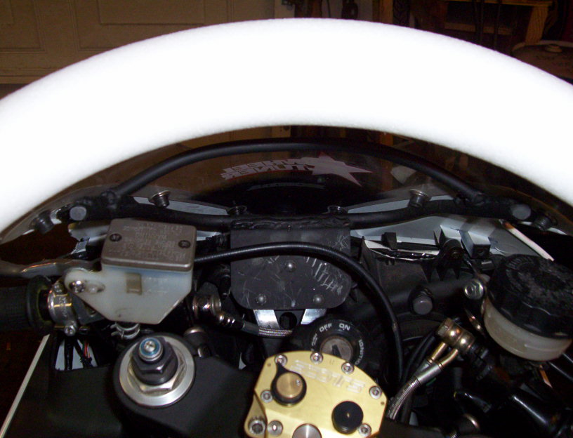

Sorry it took so long, but here goes-
I have all the stock plastic, ram air tubes, covers and all. I did have to remove the resonance chamber on the top of each tube. I pulled the plastic ducts out of the upper, heated them up, and flattened them into a more oval shape to make more room for the fork legs and lower triple clamp on either side. I had to trim my upper a little on either side to make room for the bars, and I had to cut the air duct covers where they bend up to meet the upper fairing (the area that covers the resonance chambers). I made my own upper faining stay that bolts to the stock lower stay, because my bars kept hitting the stock one....no amount of notching was gonna cure that, mostly because I have a handbrake, and also because I run my bars almost straight out as opposed to angled back in the stock position. Because of my bar position, I also had to re-locate my gauges. I like to have them, so Hinks came up with a way to put them into the back of my headlight, which worked out pretty well. Its not too bad to do the conversion, it just gets irritating when everything hits. My bars still hit the upper at full lock, but if you don't run them out as far, you probably won't have much of a problem.

here's a couple pic of the way I made mine...

Thanks Standy for the pictures so are you rocking the factory 929/954 bars? I thought you or someone mentioned something about positioning the bars to make it work is that the case? Can I just go with the factory bars stop location? When I say bar stop location I mean normally where you install the bars under the top tree not any further in or out.
I take it Standy that your stay is custom made right? Does anyone know if the 905 aftermarket stay will work????????

I run 954 bars because you can swing them out a little further due to the thinner casting, but the 929 bars work fine too. If you run either the 929 or 954 bars in the stock location, they won't hit the upper nearly as much.

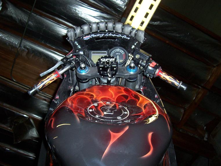

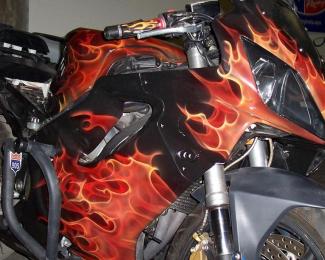

Okay guys here are a few very clear top view shots of another great fork swap complements of teamclc red flamed F4i
