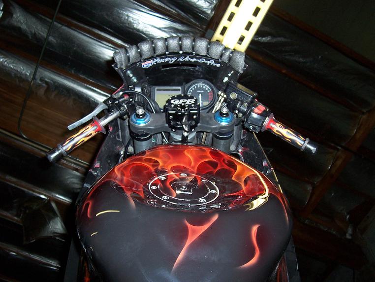

Originally Posted by GSXRFUN
Okay guys here are a few very clear top view shots of another great fork swap complements of teamclc red flamed F4i
yoyoyo, what kind of clip ons are those????
they dont look like the stock 954 929 clip ons.

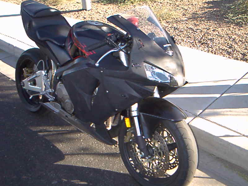

Re: Needs help on set-up of 929 forks on F4i with keeping my stock fairings
heres 03 600rr with 954 front end conversion. No modifications.... only one prob, lower clamp will cantact headlight houseing under full turn.... so don't get into any tank slappers
ID:	155854   Click image for larger version
