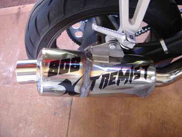

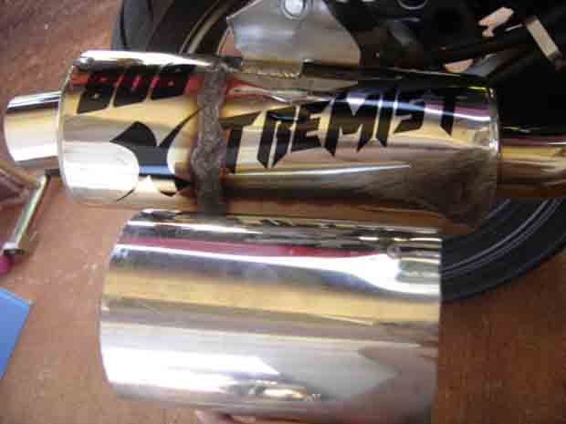

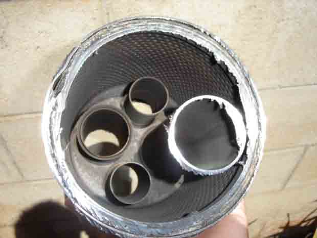

Just did mine. It's not as easy as we thought. First of all, there are three chambers in the cannister. You have to figure where you want to cut -- a chop saw is what we used (don't forget it's stainless steel so get the appropriate blade). Then we had to cut down one of the pipes inside because it didn't match up. This was the easy part.
Welding the damn thing took the longest; because of two things: 1. the ends didn't match up perfectly and 2. a fiberglass lining was contaminating the welds so it took extra technique.
Total time was around 1-2 hours, but keep in mind a experienced welder did this.
Anyhow, if you're thinking of doing it -- the only thing I recommend is to be sure to remove or clear the fiberglass lining before you start to weld. Good luck...
Hope this information helps because I didn't have any before I did mines. PEACE...

i did it with my carbon fiber micon it turned out nice... just took a lil time. had to split the can, cut the out side. then cut the tube that runs down the middle an weld the end part back up.. and boom put it back together
