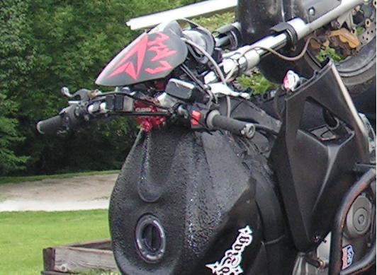

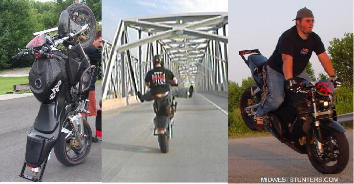

Originally Posted by LOOP
i have a gsxr 750 and have tossed a few ideas around about how to install my scotts damper with handlebars installed taking place of my clipons. the center of the bars goes right through where the damper should be.............................any ideas that have worked for you?????? thanks
I have DB bars with a GPR.........ghetto rigged it myself, but will be buying a custom fullthrottle set-up if I ever get the money for it!!!!! I cut the center out of my renthalsand mounted them around my damper. works alright as long as you find a way to keep the risers from twisting....has worked so far for me. I used the risers off of my 400EX also, but would use a riser with a flatter bottom and about another 1/4" rise if you can afford it.
I posted the same two pics in another thread, but I'm pretty excited they have actually been loading!!!!!!!

Re: how to install scotts damper with handlebars
closer view of the first pic.....of the first pic
I'm gonna get the fullthrottle set-up as soon as I get the money.....Bill is gonna make me one with a custom mount for my GPR!!!!! I did have a problem a lil while back with the left side twisting on me when rolling stoppies and pullin up wheelies....I took everything back to the triple and redid it putting JB Weld between the triple and a washer then between the washer and the riser, then tightened everything down.....nice and solid now but we'll see if it lasts.....the washer was for a little extra rise to clear the suspension adjustments.
