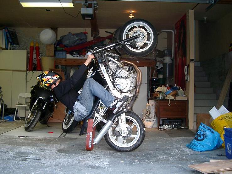

I thought I'd ask here since this is my 1st attempt at making a bar and I have no access to a welder. The sliders are skateboard wheels as well :p
(I have scraped the tail before on da heavy bike, just never with a bar)
Made from solid industrial steel... the bar itself is probably 10 pounds or something... I might add a few more mounts while it's still raining for the next week or so. It took some effort to bend that damn bar!
don't bother pointing out the brand conflict of my stickers, I don't care

just so ya know, it comes a bit over an inch from where the tail light would be (looks bigger with no plastic)

sliders look unsafe,looks like the bolt sticks out?couldnt be good if tthat hit the ground,that bar looks pretty sturdy

THE BAR LOOKS STURDY BUT THE ANGLE OF THE PART THAT ACTUALLY HITS THE GROUND LOOKS LIKE THAT MIGHT BE THROWING YOU. TRY THIS TO GET THE ANGLE......HOLD YOUR BIKE STRAIGHT UP ON BOTH WHEELS OFF THE KICK STAND AND HOLD A 2X4 AGAINST YOUR TIRE AND THE BAR....THAT SHOULD GIVE YOU A PRETTY CLOSE ANGLE OF IMPACT!

I did that with a piece of plywood when I mounted it... I'm pretty sure it'll do the job

??? looks kinda wrong. but good luck, and my prayers are with you. it looks like the bottom edge will catch at a funny angle.?? might work..post what happens

The bar sits perfectly flat on the ground so that's nothing to worry about. I am conserned about the round corners too though so I think I'll truck the bike to a welder and ask him to weld on a flat bar to the bar I already have... that should make it even better...

Hey I know you from gixxer.com . I am getting ready to fab up a bar for my gixxer. The one thing everyone told me is to add a brace to the point where the subframe meets the frame. I have seen guys run steel from the bar to the frame. The factory welds plus the aluminum wont take much abuse . GOOD LUCK MAN .

That's where having an F2 comes in handy... the whole frame and subframe are steel, and one piece, so it's plenty strong... but on the downside, heavy!
