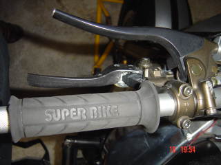

Old Jun 11, 2005 | 03:48 PM
  #33
T-Dubby's Avatar
Brap
Posts: 10,417
From: Scottsdale, AZ
Re: 636...Fullthrottle handbrake setup
Sup it's finally all setup and ready to go!!! WOOT

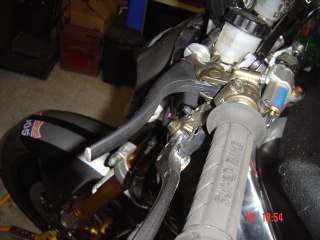

Old Jun 11, 2005 | 04:05 PM
  #34
T-Dubby's Avatar
Brap
Posts: 10,417
Old Jun 11, 2005 | 05:19 PM
  #35
*Tanus*'s Avatar
AZ's Finest!
Posts: 4,227
From: AZ streets
Im thinking of buying a clutch MC like that, how easy is it lock your tire up if your crusin @ 15mph,the one I have barly locks up with 3 fingers
Old Jun 11, 2005 | 08:28 PM
  #36
T-Dubby's Avatar
Brap
Posts: 10,417
The HB right? Um haven't really rode it..Just down to end of street back to test the brakes..Seems like it locks up really easy. Easier than the rear brake

Old Jun 12, 2005 | 05:21 AM
  #39
zx636skiv's Avatar
Avatar Wizard
Posts: 509
From: Norfolk, VA
zx636skiv is an unknown quantity at this point
Yep. that way you don't have to cover the rear brake with your foot, you just do the same with a lever! Now you can scrape high chairs and such, and have a bit more control.
Disturbed....nice looking setup...couldn't really tell, is there an adapter at the footbrake part where you connected the lines from the hb? Or is there a completely seperate line?
