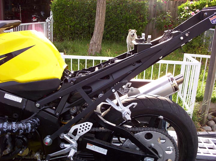

Meo was over here last night working on his bike and I took some pics of his supports for a guy who pm'd me.... These work. I dont want to argue with those who dont believe it, if you dont than dont build it. but if you want to keep your sh*t from breaking build this.
Use 1/4"X1" flat steel stock from home depot.
Use 5/8" allthread from with some flat and cut washers to bolt through your swingarm pivot bolt. Put a bolt through the side to the passenger peg mount and 2 through the 12 bar and into the subframe. Weld 1 piece of steel from 1 side to the other underneath. Just build it to look like the pics, and your troubles are over....
Good luck

more pics:

Old Apr 24, 2005 | 06:07 PM
LayinLo's Avatar
Posts: 192
From: Alabama
LayinLo is an unknown quantity at this point
Re: subframe broke on 04 gsxr 750
Looks sturdy to me.
Thanks for the pics man....Looks very good.

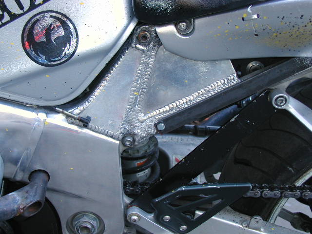

or you could do this....
Hell yeah! Tank Armor! I need to find a welder that can do that.
