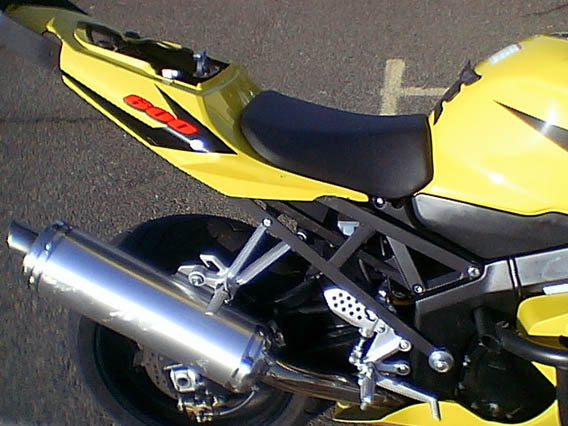

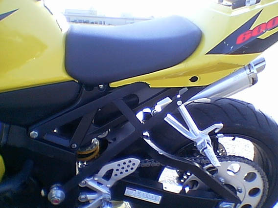

I've got a 2004 GSXR 600 and I keep breaking subframes. I know other people have had this issue b/c I've seen people talking about it on here. I've tried boxing the subframe in with diamond plate, but apparently I'm not doing it right. Is there anybody that's found a good fix for this? I really like my gixxer, I don't want another bike, I just want the ucking tail to quit falling off.

Hey, I could get some pics of my boys gsxr.... he used some plate steel and hasn't broke his yet...

Look... One of the guys I ride with built a BOLT ON support that looks clean. He scrapes his styt every time he rides, usually not hard but he has slammed the bar on occation and his has NOT broken yet....
My wife took my camera to so cal for the weekend but as soon as she gets back I'll post pics. His fix works.

Re: AAAHHHH! My #&$#*@# Subframe!!!!
PROOF!!!!
2004 GSXR 600 Stock sub frame with BOLT ON support....
http://home.surewest.net/mnordberg/meo_flip.mpg
If this doesn't convince you then nothing will.
If you want more info on the supports PM Meo here at the board....

BTW,
There was NO damage to his sub on that smack....
Now, Just to give some props to my boy, Here is one of him not fliping over the front of the bike... lol
