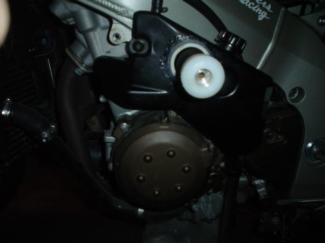

on my ZX9 i left the coolant overflow where it was and sleeved a passage through it with pvc pipe to mount my cage.

damn bro thats a good idea did you plastic weld the pipe into it or what

Just used heavy duty clear silicone that jug really has no pressure in it so it holds up fine.

Here is a pic of when i did it with extended sliders.

thats slick thanx man
