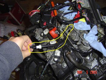

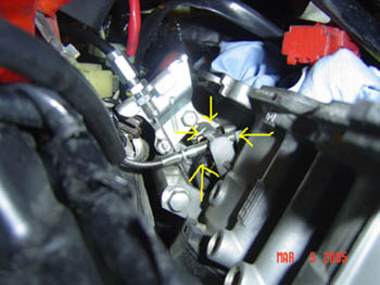

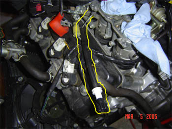

My 954 is apart. so here's some pics. Can't figure it out still?????
Please donate your bike to BVrider1...stunter in need....

Hey thanks for the pics BV rider--thats going to help a LOT---
Old Mar 8, 2005 | 07:04 PM
BVRider1's Avatar
Posts: 1,651
BVRider1 is an unknown quantity at this point
Re: 929 Idle
oh man...sorry about em pics being so small. You get the idea though.
