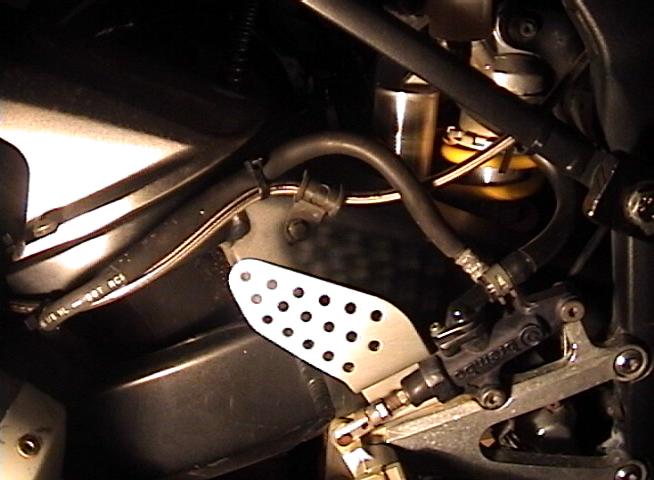

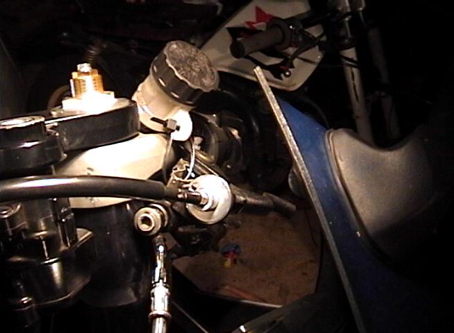

Re: Rear hand brake set-up's? Got pictures?
this is a 01 gix 1000
ID:	126030   Click image for larger version

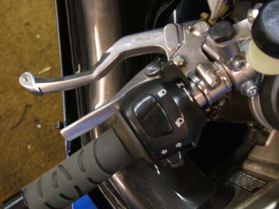

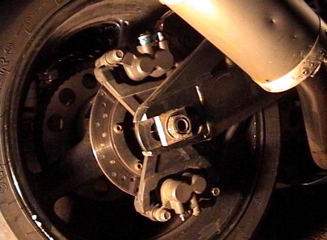

Originally Posted by GSXRFUN
Have any of you guys got some rear hand brake pictures to show positioning because I know its not that hard to figure out but maybe my bars are trimmed too much?
its not a 636 but it my r1 set up
ID:	126032   Click image for larger version
ID:	126033   Click image for larger version
ID:	126034   Click image for larger version
you guys should take the headlight/turnsignal switches off....looks much cleaner and you can use a full grip
Old Mar 2, 2005 | 03:36 PM
808stunna's Avatar
Posts: 1,513
From: maui hawaii
808stunna is an unknown quantity at this point
i am using a full grip, plus my bike is a daily driver.
junction valves suck though just be warned... i tried to get the one i have to work and it just kept blowing break fluid out the oring seal in the valve... and then i would have to bleed the system again only to have it do it to me again... moral of story dual caliper more expensive but well worth the lack of headache and you dont ruin your eyes with break fluid
i had the teardrop shaped valve and apparently the master i had was just to strong so im saving up for a dual caliper
