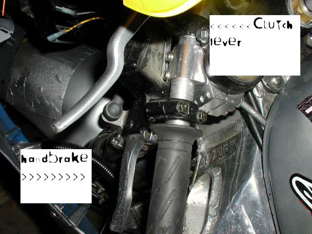

here is my setup, i got that same problem, now i just use one finger and i have so much leverage its incredible, and the msr raptor lever blows my nuts.
wow, your finger must be on very edge. nice set up though.
