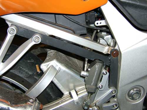

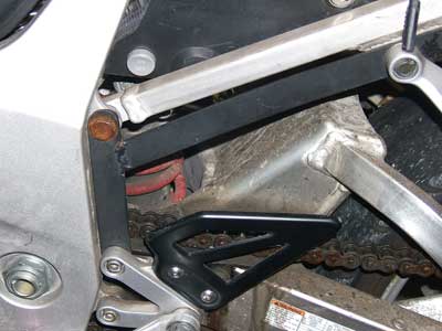

Old Jan 5, 2005 | 12:17 AM
Hinks's Avatar
Posts: 1,766
From: MI
Hinks is a name known to allHinks is a name known to allHinks is a name known to allHinks is a name known to allHinks is a name known to allHinks is a name known to all
Re: Best 12 bar.
Originally Posted by P.C.P. Tony
See you there man. Now I just got to find a way to make my subframe handle it. The gixxer subframe is weak.
original subframe from 01'
ID:	116311   Click image for larger version

I run 905 on my 750 and my subframe is reinforced by 905 too. I have small bars from my passenger pegs to my rear-set and where the bottom bolt on your sub-frame attaches to your frame I have a bar from there and runs along the sub-frame and actually welds to the 12 bar = sub frame doesn't get fuked up, doesn't break frame tabs, has been tested by my own account
