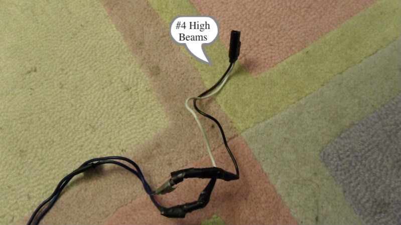

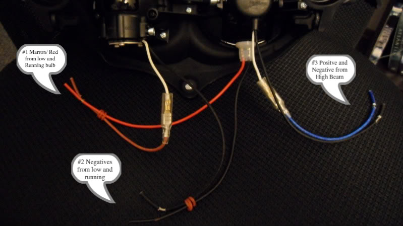

Need to clarify if these are right and will work!!
1) Twist #1 wires together and #2 wires together
2) Connect #1, #2 to number #5 low beam side black to black colors to colors
3) Connect #3 to #4 for high beams side
4) Test to make sure correct lights turn on...and Finished!!

yeah your pics are right way.
Looking at your pics the light on the left burns out all the time so id make that one your highbeam. It takes H3 fog light bulbs at autozone. Right side bulb I've used for 3 years as my running light and it hasn't burned out yet.
I'm prolly gonna change mine so there either on or off completely
