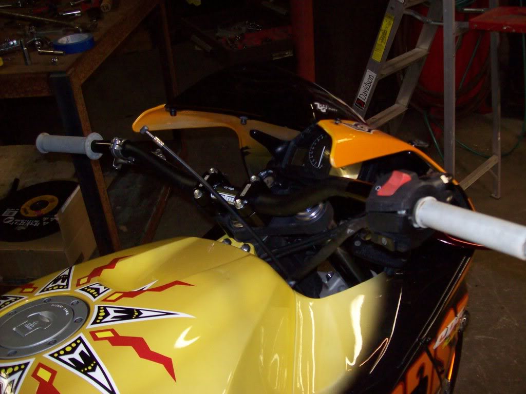

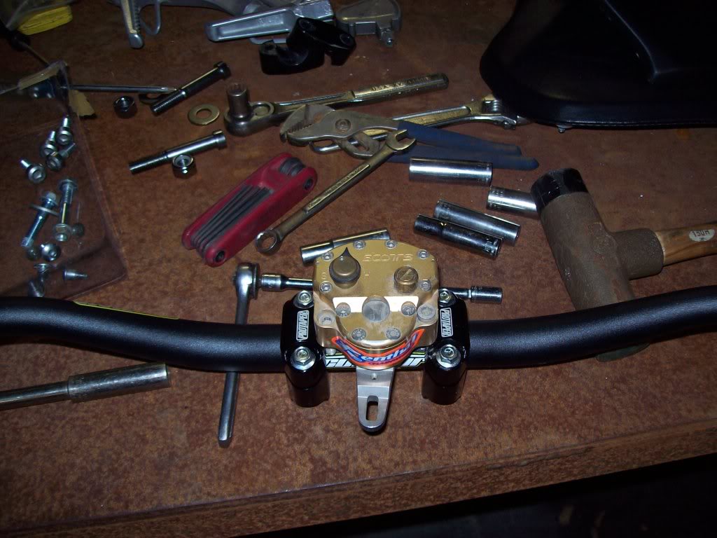

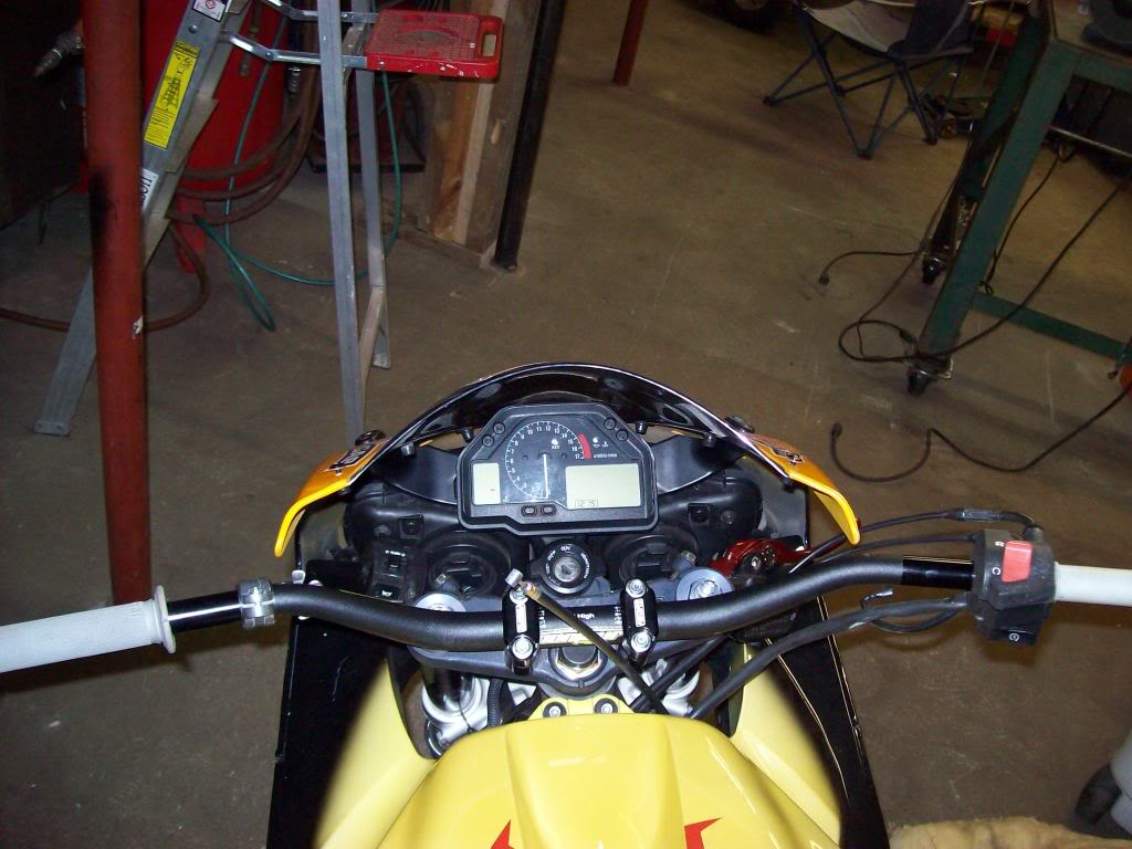

i have a 03 cbr600rr im puttin protapers on it the throttle cables reach but thats it is there a way to make the clucth cable fit and the brake line or do i have to get new brake line and clutch cable?

You will need longer cables and hope you don't plan on mounting that
damper there...

im machining a alum. bracket to bolt onto the clamps

you CAN make it work, but it's ghetto and a tight fit..
the brake line will pretty much always be tight, but a couple of my friends got away with their stocker......
the clutch cable my friend had to reroute it and cut a hole in his plastic for it to go through, kinda stupid.. I'd just get a new cable
f4i cables are longer then 600rr's, but I'm not sure how much longer..
