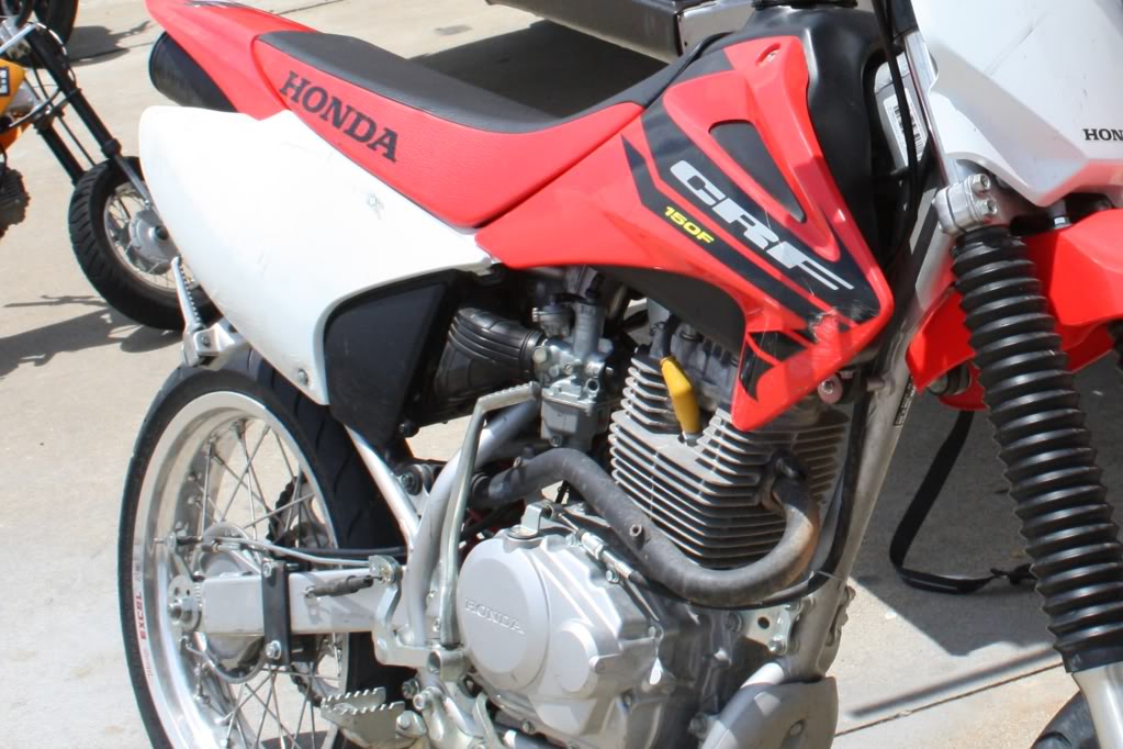

Ok most of you know I stunt the little 150f, I know I can do more than what I'm doing now. Now my question is,
What rear wheel with full hydrolic brake set up could I put on the 150f?
The drum sucks ***** for the hand brake. It barely works but I can use it cuz I'm use to it. So what should I be looking for?

i have a 150f and my handbrake works just as good as the footbrake . Try sanding the pads & hub .

the lever that you use can make a big difference in HB power.
is there cyclegear shops near you? I can tell you the best lever Ive found if there is

sand the pads and inside of the rim with 80-120 grit sand paper, hose out wiht brake cleaner, and relube the brake pivot points
It's a 150f, it has GOBS of engine brake. Drum brake is sufficient for a little bike like this.
Hell you shouldn't even need a hand brake for anything that's not off throttle hand.. But I can understand wanting one just incase
Could also extend your rear brake arm where your hand brake attaches

Originally Posted by D-WRECK
Could you put up pics of your set up?
Here ya go , for the handbrake lever i just used the stock clutch lever & cut my asv lever (the ez pull would have been a better choice for the clutch lever)
Where did you get the wheels? I can't find **** around here.
http://www.procycle.us/bikepages/crf150-crf230.html heres the link & i used the stock 150hubs .
