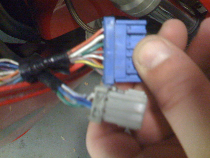

here are the two connectors... which are the correct wires, because there are two green's and the other picture of the dudes he was doing it to the white connector...

cross the wires on the harness side, before that connector, prob solved

ya, thats what I plan on doing, but which wires is it? the 2nd pic far right redd and green? but theres also two green???

2nd pic its the two wires far right, the red and green (not the green that visible, its directly behind the red).
