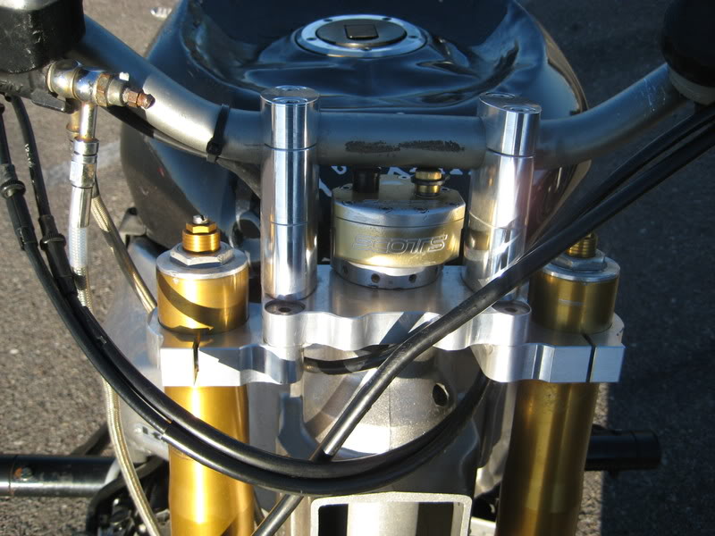

i run one
i have a upper tripple from full throttle
its awsome, so many diff variations can be run with this set up
mods u can do on the stock set up is, drill the holes for the risers
and then put down the mounting bracket exactly where it needs to go and tap in 2 threaded holes into it where u would mount the damper on the mount stay, and run longer bolts that go thru the damper and thru the mount bracket into the upper, make sence?
or just buy the upper from bill cause its way better
heres a pic

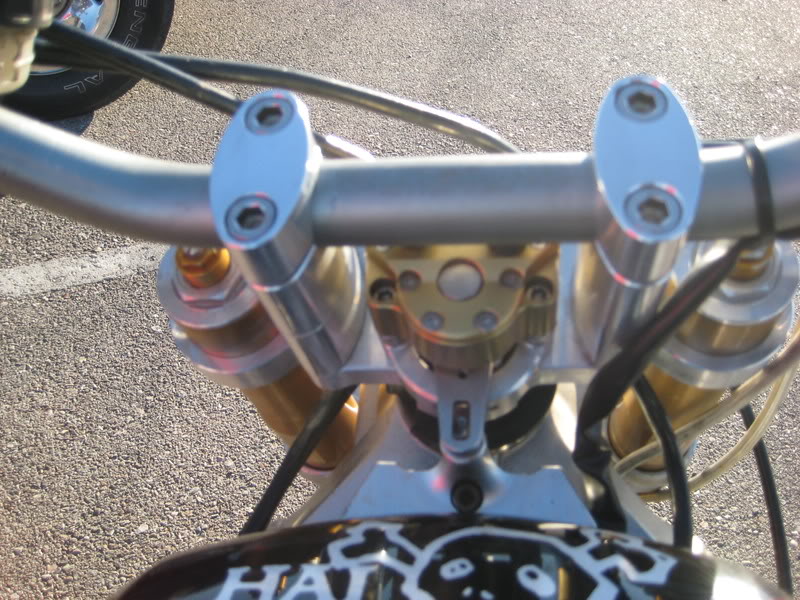

Here's a pic that Bill sent me of the tripple. Dont know if this is for an F4i or what but this **** is hot.
Or I got these for my F4i but he said he could make them for other bikes.too:

yeah the pic where the bars are cut is what im looking not real sure about cutting my bars i just dont want to have the high bar risers i was thinking about maybe weilding something to the front of the ttc

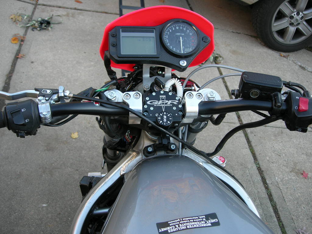

here is a better pic
