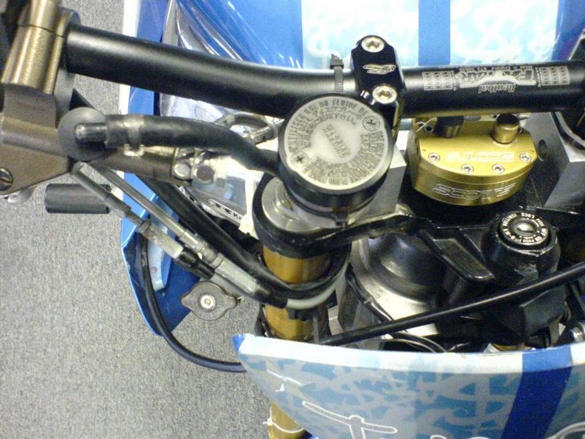

Originally Posted by 05R6on1
come on someone hit me up with soem pix of thier setups
This is Tnecks - I'll post one more I have from someone else.
Name:	TNeck DBB w Damper.jpg
Old Sep 20, 2007 | 12:11 AM
OnEWhEeLNEAL's Avatar
NealFoReal
Posts: 36,000
From: QUEENS, NY BITCHES
Re: DB bars With Stabilizer?
And this one is Dizzle. I was looking a while ago and saw these pics of setups. I think it was Tneck said that he made the risers a little higher so it would fit.
