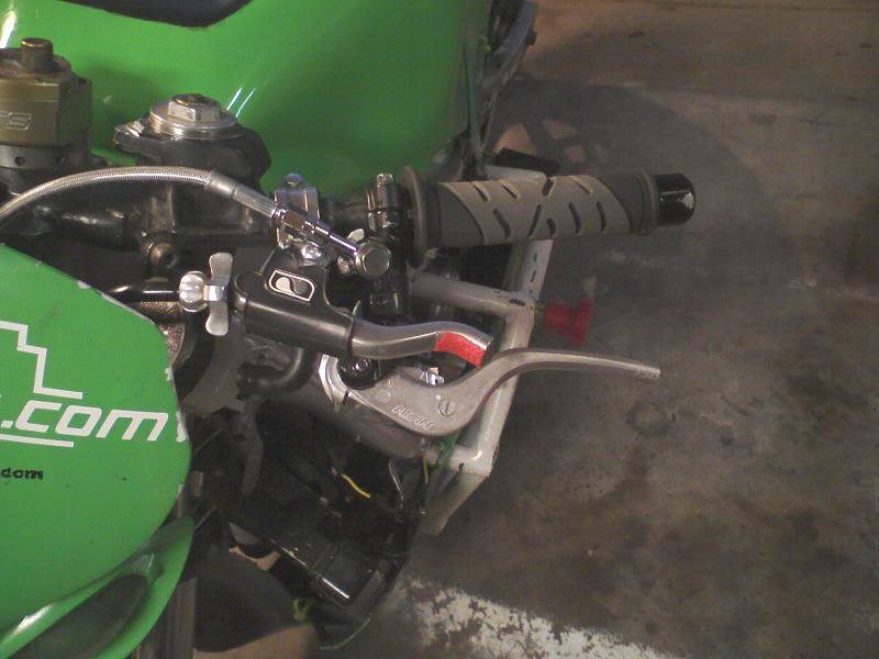

heres my setup
msr pro raptor clutch lever and a radial from an 05 gsxr 600
its like butter..so smooooooth
