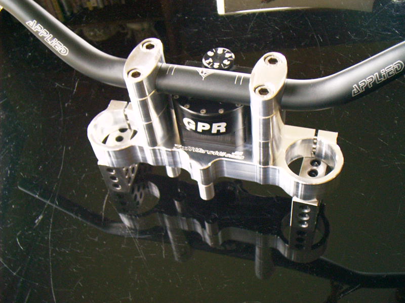

I want to mount motocross bars on my 2002 gsxr 750 and still keep my scotts steering stabilizer!!!!! All the setups I have found dont have the clearence needed. Does anyone know whare I can find the setup I need to do this??????? I find it hard to believe there is nothing out there!!!!

I've got an extra tall set of risers that were made for my fullthrottleinc tripple so I could keep my GPR on there.
I have a Hyperpro now and regular risers, so I'm not using them.
Could sell em for $35 plus shipping ($50 billet aluminum risers from FullThrottleInc.Net) Just PM me and let me know.

this is really expensive but it fits your needs
www.fullthrottleinc.net
3. Purchase a Fullthrottleinc billet top clamp. This is the way to go if you want more flexibility than the lsl kit offers. With a Fullthrottleinc top clamp you have the option of running 1 1/8" fat bars and the riseres are interchangeable if you decide later to switch to 7/8" bars (or from 7/8" to 1 1/8"). In many cases they have been designed to accomodate a steering damper. These top clamps are precision engineered to be stronger than you will ever need them to be. When the bombs drop it will be ****roaches and Fullthrottleinc top clamps left to rule the earth. Individual top clamps start at $350 for most sport bike motorcycles.
thats exactly what I had made......I got the risers and risers block exactly like those, so if you decide you wanna save up the money and buy a triple from bill at fullthrottle(highly recommended----uber pimperiffic).....you'll already have a set of the risers!
e-mail being sent to ya.......figure shipping at $8(usually $7 and change for stuff that size)
