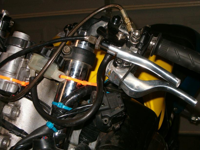

Here is a pic.. if I put the hb on the outside then the line won't clear the adjuster at all.. any ideas? Am I going to have to get longer bars?

Old Jun 6, 2006 | 05:07 AM
*Tanus*'s Avatar
AZ's Finest!
Posts: 4,227
From: AZ streets
Re: 05 r1 master

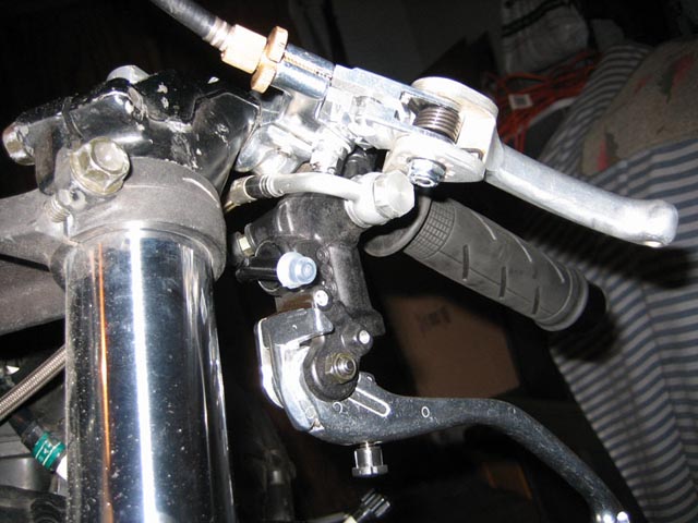

this is a 05 gix master, but Ive had a 05 r6 set up similar

Old Jun 6, 2006 | 01:41 PM
hyperryder's Avatar
Posts: 2,420
From: MD
hyperryder is an unknown quantity at this point
Re: 05 r1 master
youy need to get a moose set up its the only one i have found were the lever has a good bend in it so when you pull it it dose not hit the banjo bolt

number 1 the asv ajust lock nut take it off, unclamp the asv and cable and run it under the banjo bolt and slide the asv ajusted right under the banjo bolt. clutch on the out side.

Hmm.. i might have to pick up one of those moose things.. i want the clutch on the inside.
Hyper, are you talking about that ultimate clutch system?? That thing looks nice..
What's that piece at the bottom? Looks like it might get in my way somehow..

hot start lever for dirt bikes they make them without it also

try putting the hb on the inside. my 1000rr with the moose is money i will try to get you a pic later.
this is how mine is also but the 1000rr comes straight out
http://img118.imageshack.us/my.php?image=hb39cq.jpg
