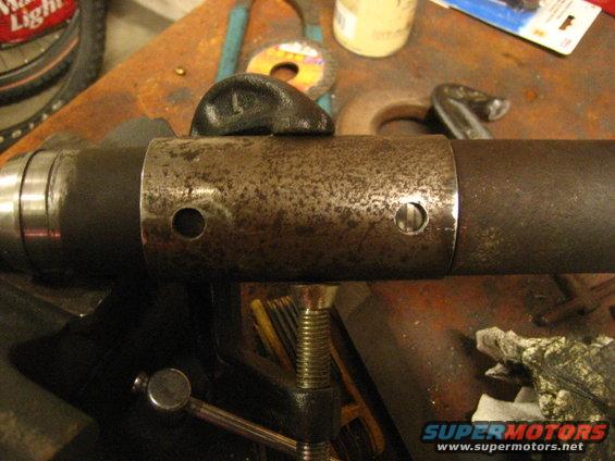

If you have no welder you can get a tube sized to go over the out side of the cross bar (about 75mm long) them drill two 7mm holes straight through 20mm from each end of the tube. then fit the cage with the tube over the cross bar . Slide the sleeve over the joint so its 50/50 them mark the holes that need to be drilled in the cage. Take apart and drill the cage holes but it all back together but 6mm bolts through your holes and tighten. It would be better if I could draw it but my PC skills are not there i'm affraid.
This is a picture i googled for might help...
Pez

Re: SICK INNOVATIONS CAGE fittings (f4)
perfectico!
thanks for that Pez - might have to get my drill out then!
