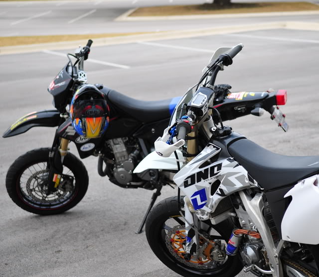

I have a hinson slipper clutch and a brembo 16x18 on the way. I still need to figure out which caliper and rotor to go with. The stock master and caliper work great for riding around town but they suck when riding hard in the twisties. Should have some more pics up soon.
I did add a red bull catch can..lol

The tail light and plate bracket are from Baja Designs. You don't need turn signals in Texas. Only a headlight with a high/low beam, tail light, brake light, one mirror, and a horn.

The bike has a hinson slipper clutch now and handbrake. I need to get some more pics up .
