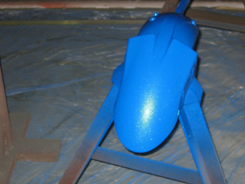

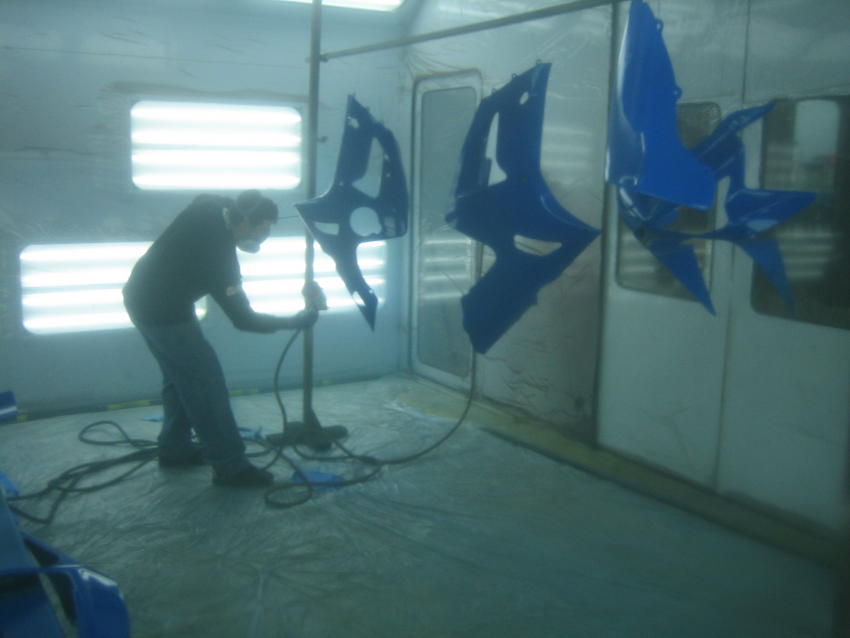

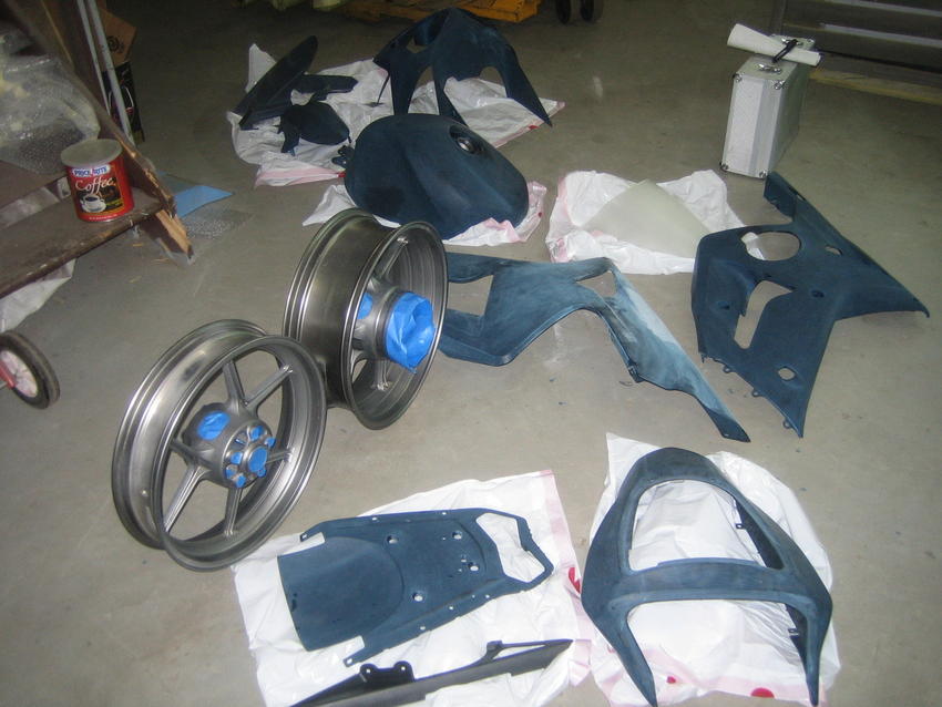

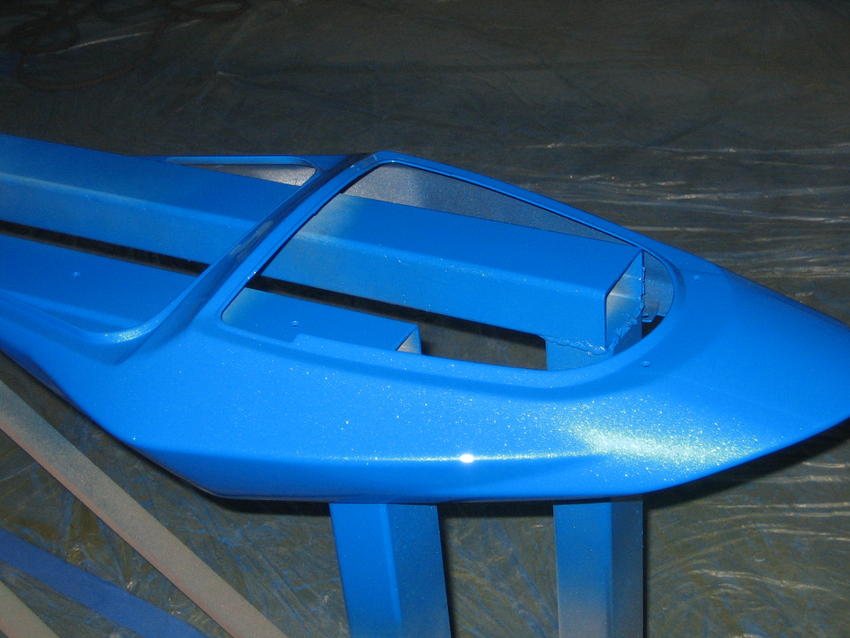

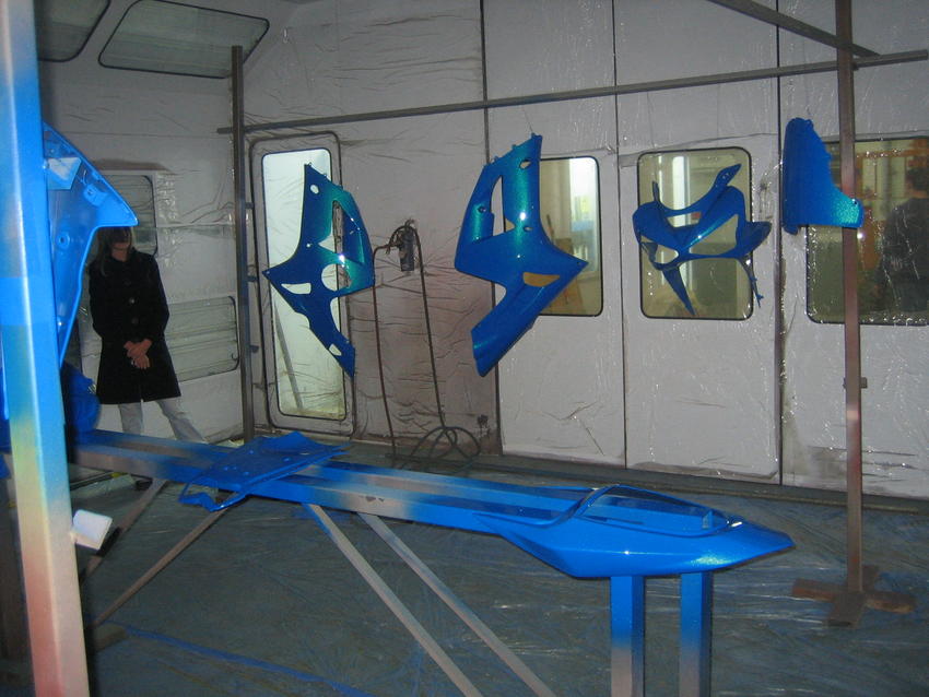

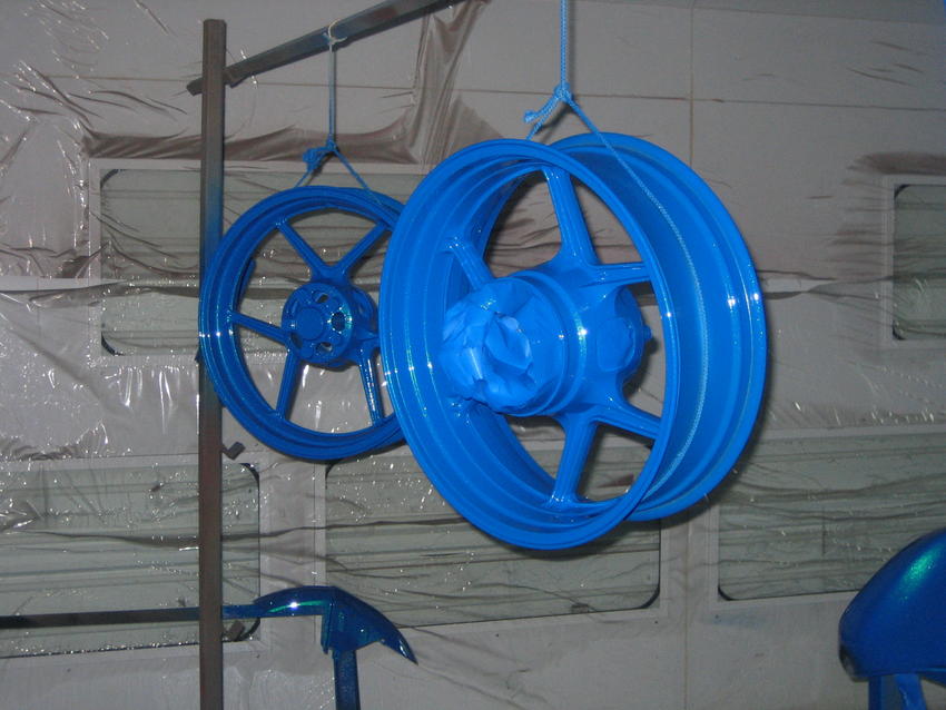

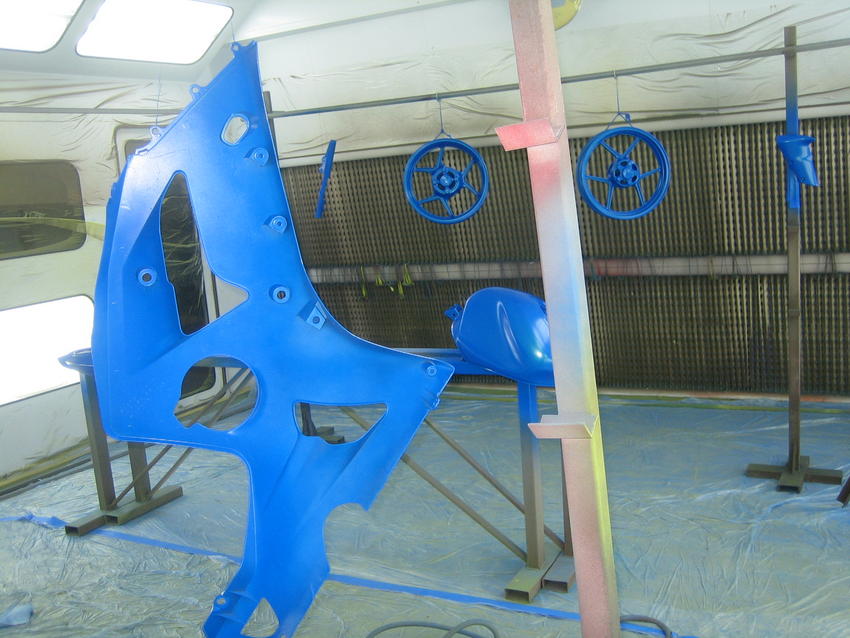

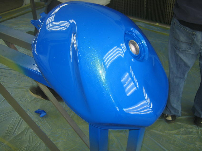

My boy parsons was busy last night spraying away. Came out way better than I thought. It looks blue inside but when a little light or sun hits it it turns to a shade of green sparkle. I started hand sanding this last summer so its been a long process. I'm kinda bummed about a previous crack in my upper that has resurfaced after we spent a lot of time repairing. O well I will just deal with it for now and get a new upper later. The spray booth was a little dusty so there is some dust specs here and there. Might wet sand it and shoot two more coats of clear on it to make it look like glass. I think Mat sprayed 9 coats on top of the primer total. 3 base coat,3 mid coat,3 clear. I got like 75 pics so I will just a post a few for now. I won't have it all together for a while still I still got a few tedious things to finish on it first.
The color is twilight blue. Looks a litte like baby blue in these pics but in person its way different and much more green.

are you not going to dent the tank?

nope, Ive been riding a bike with a dented tank for 7 years. It get old on the street. I love to be able to put a full tank of gas in it. This bike will be lightly stunted only. Might get another tank,dent it an paint to match.

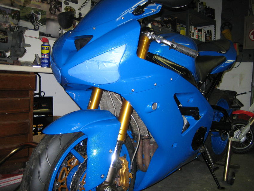

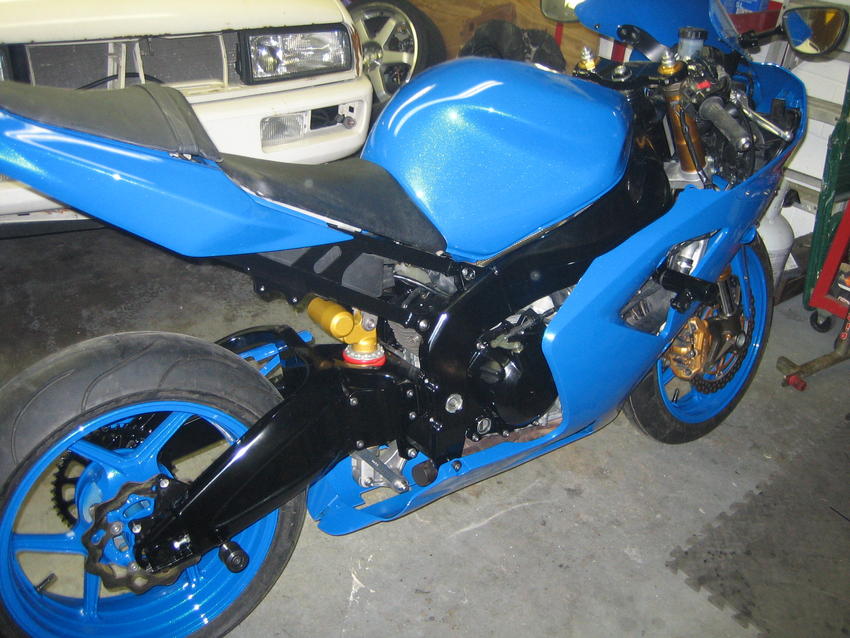

Got it mostly together. Its now getting wet sanded and re cleared
