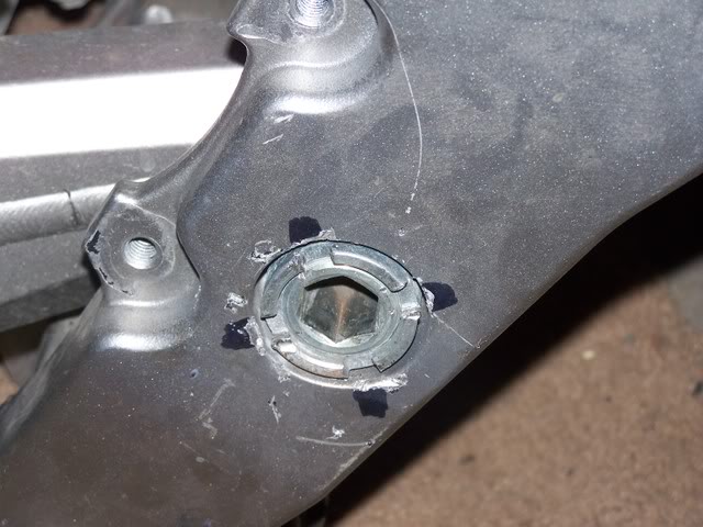

Originally Posted by MikeM
do you have an impact gun?
The tool keeps slipping off and its only "supposed" be torqued to 81 foot pounds...I now need to get a new nut due to it being mangled...its 1 of them spanner type nuts....
I made my own tool for it but it did not work..ordering up the $80 kawi tool tomorrow
Old Mar 8, 2009 | 08:49 PM
  #4467
Re: Omr subcages !!!!!!!!!!
take a pic .... what size is it???

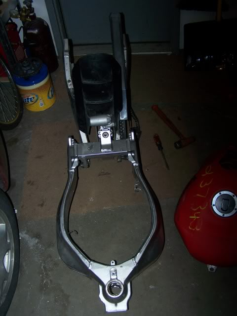

hopefully you don't trash the 80 dollar tool on the mangled nut
I'm actually thinking of bringing the thing in and having the stealership take it off so they can ruin their tool
Why is it so damn hard to take the swingarm off
I'm gonna buy the tool becouse I will need it a few more times....
hold on a min.....
37mm o.d. 34mm i.d.
wait a minute isn't the nut on the left side of the swing arm bolt just a regular nut ? i would look at mine but my cage covers it
yes it has a reg. nut on the left side but it also has a spanner on the right...you loosen up and remove the spanner then spin the shaft out the right side

37mm o.d. 34mm i.d.
f4i has the same thing. you can use brute force to spin the shaft, and THAT will losen the spanner nut

37mm o.d. 34mm i.d.
did you loosen the nut on the left side ?
Well......... I made a tool to go into the shaft by welding a nut/bolt together to try the force thing (grade 8.8) and all I did was twist the bolt nearly till it broke
I also try-ed a large drift and hammer....
and making a tool out of a 30mm socket
Old Mar 8, 2009 | 09:09 PM
  #4479
Mr. Hooligan's Avatar
Posts: 11,214
From: St. Paul MN...
yes
its taken off and in the bolt bin
