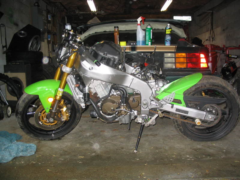

Re: subframe cage
Originally Posted by aw0n0
you need more than rearsets
nooo sheeyot look at the left slider/motor mount! Damn, I hope it's only the hanger bolt that's bent...
Old Jun 4, 2007 | 07:05 PM
  #707
Re: subframe cage
it's a bent bolt ?
636 has a nut and a bolt so it's just a matter of putting in a new bolt
Old Jun 4, 2007 | 09:22 PM
  #708
letsride's Avatar
Posts: 12,123
From: Northeast
Re: subframe cage
Its just a bent bolt. The frame tab for the subframe is snapped but it getting welded. Now all I need is a tank, tail, undertail, rear seat, streetfighter light.
ok cool, I was hoping there wasn't a broken motor mount on the other side of that. btw looks like you need a new chain (or is it suppose to be orange colored) and gears. bout time you got a bike man how much did you get it for?
The chain will be put in coke to get the rust off. I got a spare wheel, ill be getting another chain and up 10 + not sure yet. but thats going to be for the spare wheel so I can change them in and out for street riding.
I paid $1700. Spent $400 on parts so far I plan on spending another $700.

Get a new chain and two sets of sprockets... a +1,+6 set for streets, and a -1,+11 set for lots, and you can run the same chain for both. Keep the +11 on your lot/burnout wheel/tire and the +6 on your street wheel/tire.
