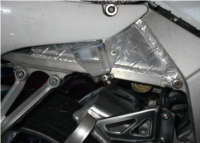

Mine broke so i welded it. It does'nt feel like im standing on a wet noodle anymore. Also put a peice of pipe between the rear footpeg mounts it helps alot too.
DAM !
NOW THATS WHAT IM LOOKING FOR !
LOOKS FUKING GOOD AND STRONG WITH THE DIMOND PLATE AND THE PIPE IN BETWEEN THE PEGS IS ANOTHER SWEET *** IDEA !
SHOULD BE GOOD AS LONG AS IT DOND BEND SIDEWAYS ......
1 MORE QUESTION.....
HOW DID YOU MOUNT THE PIPE INBETWEEN THE PEGS ?
I'M GUESSING BUT ...IT LOOKS LIKE YOU WOULD USE A PEICE OF THREADED ROD WITH A NUT ON EACH END THEN A LARGER SIZE HOLLOW PIPE AROUND THE THREADED ROD ?
DONT MEAN TO BE A PAIN IN THE *** BUT I THINK THIS MIGHT HELP EVERYBODY THAT HAS THE SAME DAM PROBLEM WITH OUR GSXRS .
COULD YOU POST SOME PICTURES OF THE PIPE FROM UNDERNEATH ....AND A LITTLE HOW TO ON IT ALSO.
THANKS FROM,
ALL OF US GSXR STUNTERS.

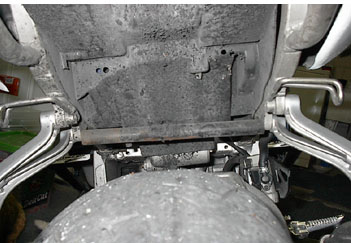

hah you should see Bryans 929 its been welded so many times. Johns is also cracked.
The best tip on how not to break them has alreadt been said, NO GORILLA SCRAPES The pipe I put in mine, Idoubt does anything now that its welded but it does help stock subframes. I took out the front bolts to the foot peg and ran a piece of allthread though them also going though a piece of an old jack handle I cut to size.
