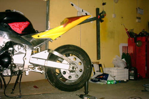

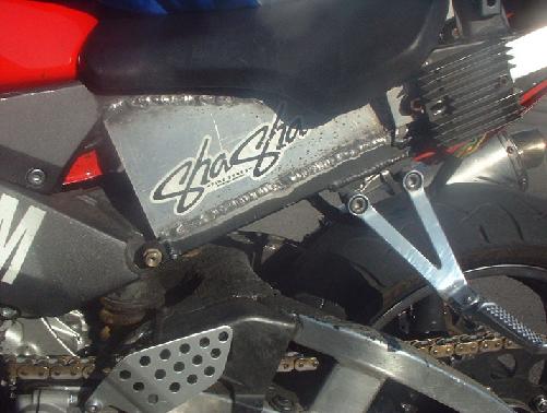

my man Crazy Dan had this on his site:
sub-frame - I recommend welding in a brace or some kind of reinforcement. you can see my sub-frame is braced up with 1/2 aluminum from the front to the rear. I snapped my first sub-frame practicing 12's. I was practicing them at slow speeds and was able to get away from the bike. If my frame would of snapped at a higher speed, the bike would have come right over back on me and there wouldnt have been anything I could have done to get away. keep a eye on your frame all the time for small cracks and bends!

looks like crap but a good idea non-the-less. :YEAH
yup...looks like crap...but a damn good idea!!! How is holding up? Can you guys tell me at what point of the subframe the R1 usually cracks or snaps at? thanks brutha :YEAH

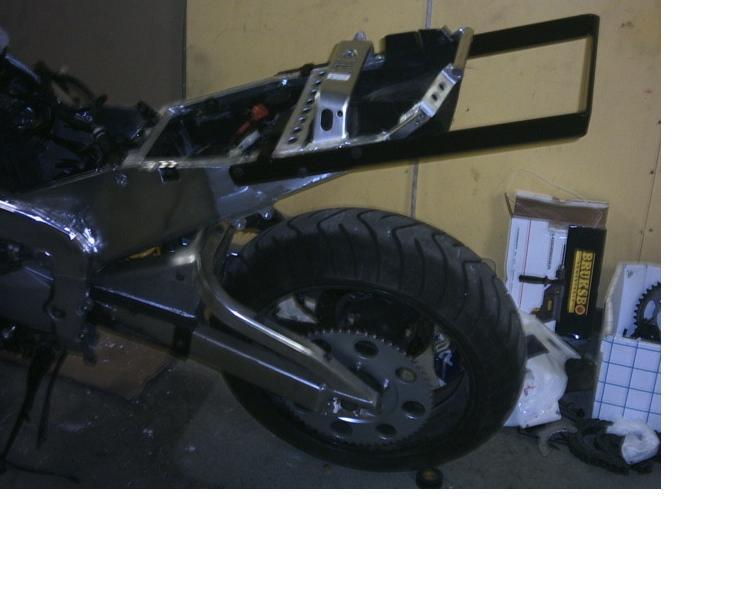

A buddy´s bike. Its still untested because of all the damn snow.
im the buddy sorry bad picture

I think that looks ....if you clean up the bike and put on all the fairings, it would look really good. Cant wait for you to test it out. Post up whenever you test it.....looks like im about to reinforce my subframe :YEAH
