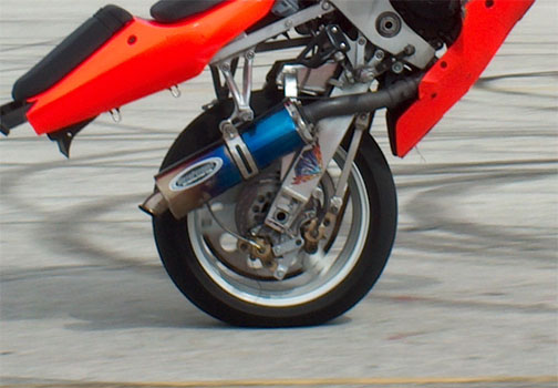

Best way
You dont want to "half ***" it on this one. front brakes work well because there are 2 giant rotors up there but you just dont have good leverage to run an extra cable to the existing rear brake.
The best way to do it is run an extra caliper with a long steel line up to an extra FRONT brake caliper on the left hand side

Re: Best way
Do you have a pic of his moto bar setup?

We got this all figured out now, just need to get the extra long brake line and get some stuff welded. We'll have it working by the end of the week!!!!
