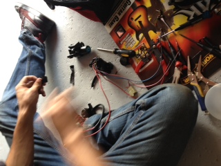

thx man i bought diode and resistor hoping to modify on that damn cheap chinese ignition so the voltage for the fuel pump can be right,,but even on the chinese ignition i dont kno which wire it is .... i cant return it becuz i cut it .,50 bucks down the drain
im gonna do the toggle switch temporarily...

It's the pink wire on the oem switch.
Voltage should drop to 9 vdc after you solder in the diode.
