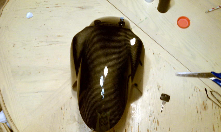

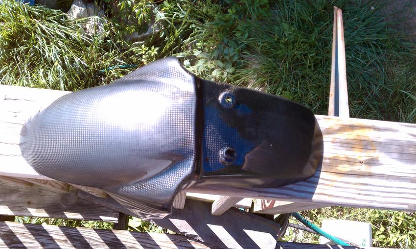

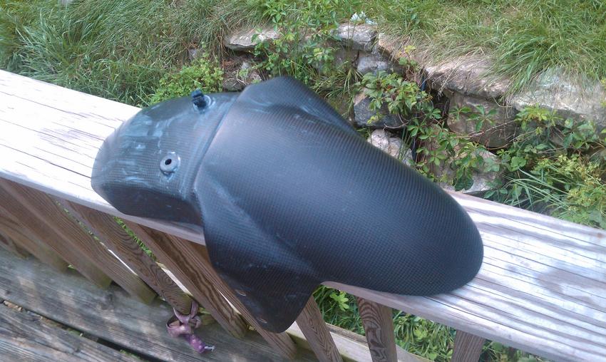

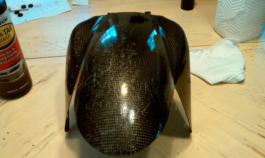

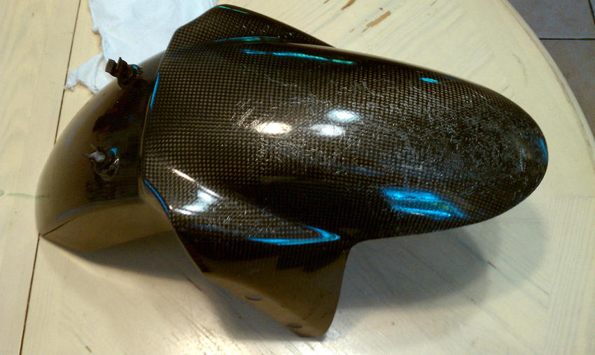

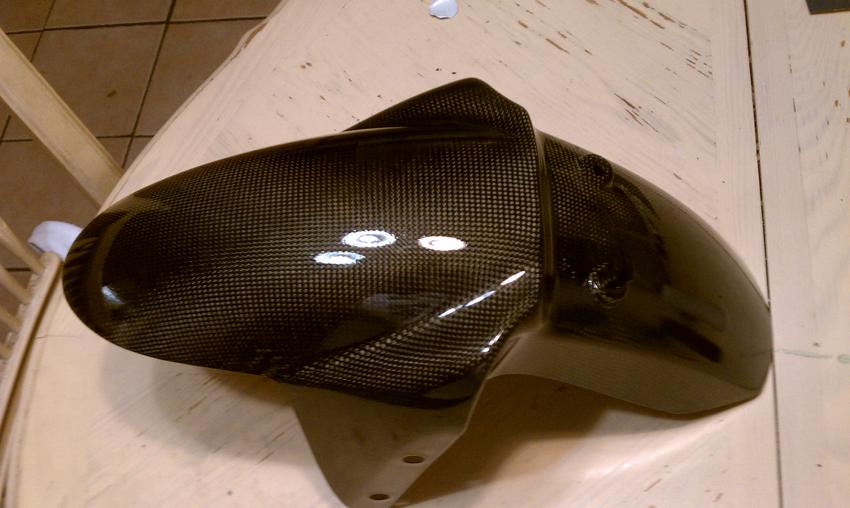

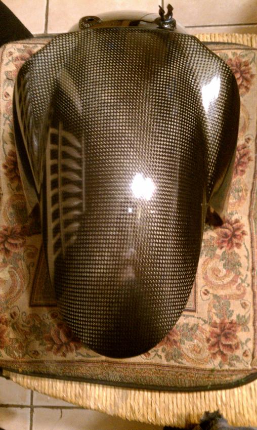

just took off my shift-tech carbon fiber front fender as the clear coat has begun to peel...Did some wet sanding today with 1000 grit sand paper and threw two coats of clear on top of it...tomorrow i will wet sand it again with 1500 throw another coat of clear on wet-sand with 2000 and buff her out and see how it goes. I will upload some pics of the finish product for those who are interested.

for some reason it seems the clear on carbon fiber starts to oxidize fast

i probably should have labeled my attached images better...i posted pictures of before i sanded it..than after i wet-sanded with 1000 grit and spayed 2 coats of clear over it as i stated in my original post...but i forgot to take pictures of what it looked like after the 1000 grit sand before i sprayed the clear thanks for the info tho. Tomorrow ill do the 1500 grit shoot another coat of clear..sand with 2000 and than buff

most carbon fiber is not clear coated, its just the bare resin. I'm sure its not UV stable and thats why it chalks up.

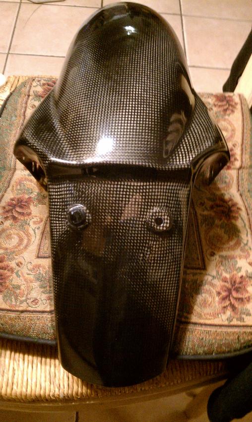

Finished The Front Fender!!!
PICS
